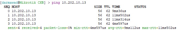

From mikrotik side, I was able to ping to zabbix server at remote network. From cisco switch side, I was able to ping to another server at remote network but not to zabbix server.

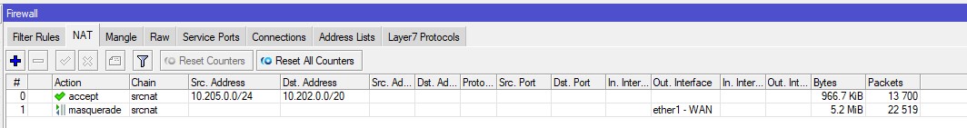

I did some research on google and found some suggest to create a new firewall NAT rule to allow specific source and destination right above masquarade NAT rule.
I already did, but still no luck.

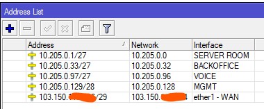

do ping on mikrotik from: 10.205.0.1 to: 10.202.10.13
on zabbix
tcpdump icmp and host 10.205.0.1
Hi Panisk,
Below are the outputs :
[darmawad@Mikrotik CKR] > ping 10.202.10.13
SEQ HOST SIZE TTL TIME STATUS
0 10.202.10.13 56 62 8ms436us
1 10.202.10.13 56 62 8ms954us
2 10.202.10.13 56 62 8ms530us
3 10.202.10.13 56 62 6ms199us
4 10.202.10.13 56 62 11ms204us
5 10.202.10.13 56 62 8ms656us
6 10.202.10.13 56 62 13ms601us
7 10.202.10.13 56 62 13ms804us
sent=8 received=8 packet-loss=0% min-rtt=6ms199us avg-rtt=9ms923us
max-rtt=13ms804us
