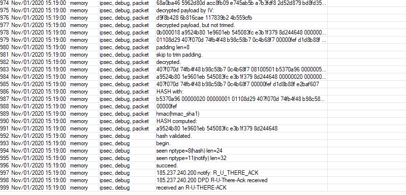

i created schjeduler for
/ip ipsec installed-sa print file=ipsec append
every 5 minutes. Waiting now for the tunnel problem and i will post file here.
Tunnel not working but not for all subnets of peer, just for one local subnet, another sees tunnel ip. Thats strange.
