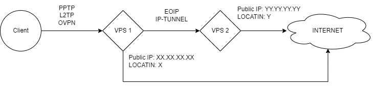

I have two VPS that have Mikrotik v6 installed on both of them and as they are VPS in separate geo locations obviously they have very different IPs. What I am trying to achieve is as follows:
the client connects to VPS 1 via PPTP, L2TP, or OVPN and through a tunnel connects to VPS 2, and via this route, they would be able to surf the internet. Obviously, both of these VPS have their own internet connection but I want VPS 1’s traffic to be directed to VPS 2 and VPS 2 only gets the packets and contents from the internet and returns them from the same path to the client. I am not sure if this is possible or not but it looks logical to me o be possible.
This is the schematic of the connection.
