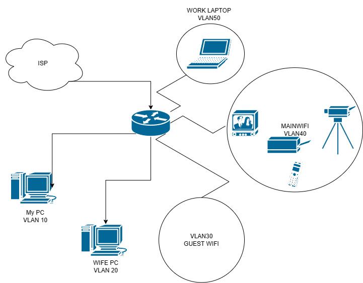

Im planning to make it look like this:
VLAN 10 - 192.168.10.0 - WiFi for phones
VLAN 20 - 192.168.20.0 - WiFi for work notebook homeoffice
VLAN 30 - 192.168.30.0 - WiFi IoT - vacuum, washing machine, TV(i dont know if should TV put there)
VLAN 40 - 192.168.40.0 - kids room cam, the problem is that cam need to be connected to network for i can use it on my and wife phones, if i cut the internet, it will only work in main app for me, so still idk how to figure it out, the cam without power over day, its only for night, if everythink is ok when they are sleeping. I will start looking for some cam that dont need to be in some 3rd party cloud.
VLAN 50 - 192168.50.0 - ETH2 - my computer
VLAN 60 - 192.168.60.0 - ETH3 - wife gaming PC
What i saw, there is several method to make “VLANs”. But i cant still find the right guidance for me. :slight_smile:

No, im not, but i like it. :smiley: Im starting to reading the guide what u reffered. I would like to prepare it like this. What you think about that? For the VLAN40 i will enable client isolation. The WIFE PC i want it to be separated if she donwload some malware, but i think that i can put it to VLAN 10 and make isolation too? Hard to decide without experience for me. Thank for your tips. :slight_smile:. Sorry for ugly diagram.
