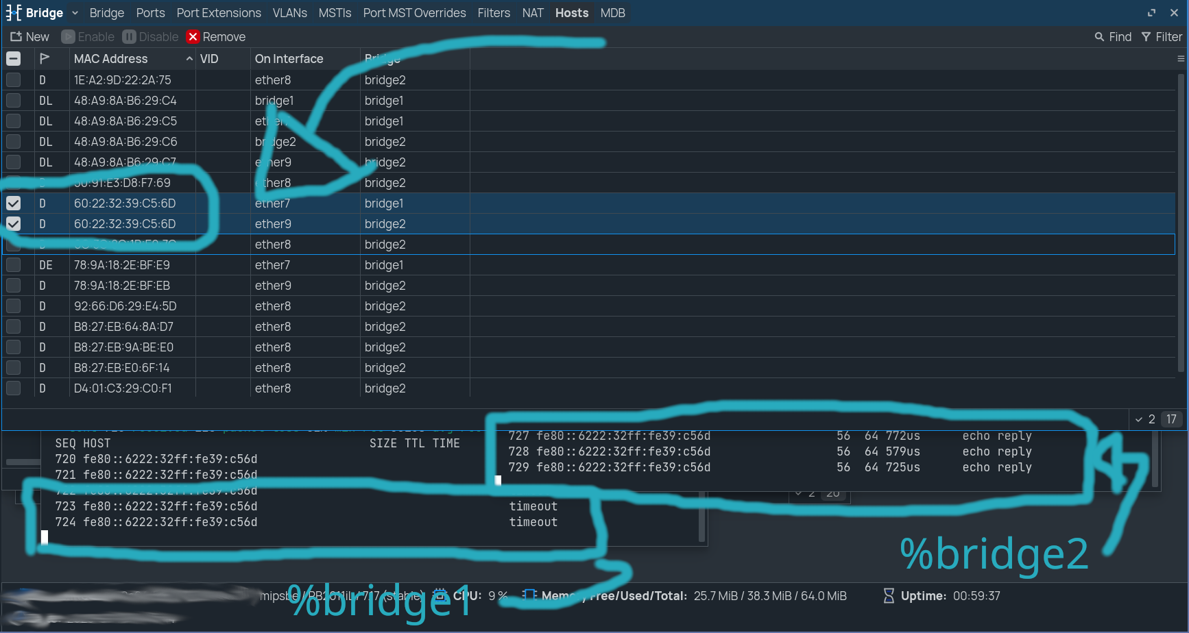

Now I have a scenario whereby I have a device (call it dev_a) connected via Ethernet to one of the enslaved ports of bridge1
and then I have another device (call it dev_b) connected via Ethernet to one of the enslaved ports of bridge2.
Here’s the kicker (although I never assumed it should have been one because there is nothing wrong with this from
my networking understanding at both L2 and L3), dev_a and dev_b both have the same MAC address, but that should
be no problem - they are after all on different bridges:
Okay, still fine.
Now, we know that with how IPv6 link-local works that means the Linux kernel running on dev_a and dev_b
is going to derive the link-local interface address from the MAC address (which is the same on both devices),
meaning both dev_a and dev_b will have the same IPv6 link-local address (this should still be fine as they
are on seperate L2 networks).
When I ping the address like so:
ping fe80::6222:32ff:fe39:c56d%bridge1
And like so:
ping fe80::6222:32ff:fe39:c56d%bridge2
I noticed that only the second one (over bridge2) responds. The one over bridge1 sometimes
does but is flaky - more timeouts than replies received. If, however, I unplug the ethernet cable
that connects dev_b to bridge2 (meaning that the entry for the MAC address disappears from
bridge2), then the ping for dev_a (over bridge1) starts working again.
Can someone either tell me I am crazy, because this setup should work.

I have looked at the IPv6 neighborhood list and it shows information I expect. The link-local address behind bridge1 and the same
link-local address behind bridge2. That makes sense; none of this should be a problem yet on RoS it seems to not work.

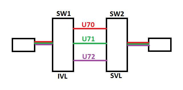

It would be helpful if you provided a diagram, and what the devices involved are.
What is the Ubiquiti device that has vlans? An edgerouter? ER-X or ER-6P?
What is the vlan-aware switch? Is it a switch that supports and is configured to use IVL (independent vlan learning, where the vid is used in addition to the mac address when storing the [mac/vid] to switch-port table), or is it SVL (which uses only the mac address) in the mac to switch-port (assumes that same mac won’t be a member of more than one vlan).
If it is SVL, it is possible the switch is relearning the port that the mac address is coming from (when received from the mikrotik bridges, regardless of which vlan is involved.
And that will cause problems. google SVL vs IVL
Then consider what happens if you have two switchs, one configured for IVL and one for SVL with “access ports” connected between the switches, and trunk ports connected to two vlan-aware devices.
If only a single vlan is used, there isn’t a problem. But if you use multiple vlans simultaneously, the SVL switch will have mac table trashing, as it will see the port that the mac address of a specific device as changing between the three access ports, and packets will be dropped.
