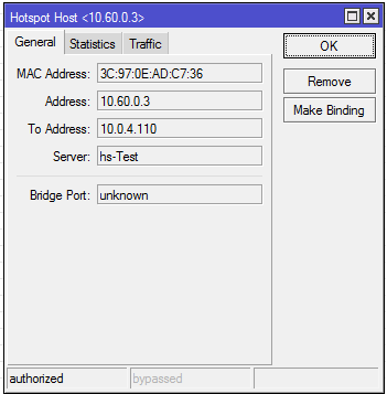

I set up new server and everything is working until I login to hotspot. When I login on second hotspot server it shows that To Address on Hotspot->Hosts is from first servers subnet, but Address is from second address pool. So as address is from wrong pool everything stops working.

So the problem is that after I login then To Address sets to wrong first servers pool and network computer can’t reach anything on network.

That doesn’t help. In both cases if I set pool to what I need or I set it to none, everything works correct only before I login to hotspot. If I login on first hotspot it shows To address from its pool. But when I login on second hotspot it shows that Address is from correct - second servers pool, but To address is from first servers pool and computer can not reach even it’s gateway.
