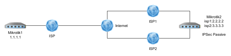

I have two mikrotik, first have one isp and works like ipsec initiator, second works like ipsec responder. I wand install two ipsec connections, but it’s don’t work. Single ipsec connections are work< but two at same time is no…
Lab scheme and configs:

What I normally do is that on the responder end, I configure two peers with distinct local-address settings, and make sure that the route to the initiator takes into account the local source address (which is what your /ip route rule items do) or that the connections are marked to stick responses to incoming connections on those interfaces through which the initial request came (so you would be assigning the routing-mark based on connection-mark rather than on the source address). Second, I use the xauth mode so that the responder doesn’t identify the initiator by its IP address but by its xauth user name. It is possible that just one of (xauth mode, two peers) is necessary but I hazily remember I needed both.
Thanx, i will try to config with xauth and write about the result
Before doing that, follow the advice and explanation of Mikrotik support’s IPsec expert @emils in this almost identical thread.
And I have to apologize for misleading you - in my setups it is actually always the initiator which has two WANs, so the intuitive (and wrong) understanding of the purpose of the send-initial-contact=no as something just preventing the peer from actively initiating the establishment of the IKEv2 SA doesn’t prevent the setup from working because in my cases, I do have this setting on responder side (activated using passive=yes) which is also the side where a common IP address is used for both IPsec “sessions”.
