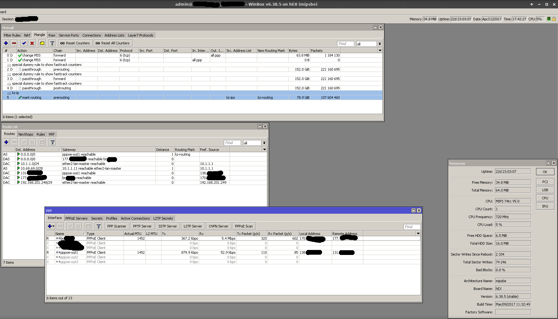

My setup works fine with two pppoe-client, where one pppoe with default-route=yes and the second pppoe with default-route=no. I mark the connections from range2 and works with no problems.
My code:
/interface pppoe-client
	add add-default-route=yes disabled=no interface=puro-lulz name=someisp password=yyyyyy use-peer-dns=yes user=xxxxxxx
	add add-default-route=no disabled=no interface=puro-lulz name=pppoe-out1 password=yyyyy user=xxxxx
/ip firewall address-list
	add address=10.1.1.88 list=kz-ips
	add address=10.1.1.40 list=kz-ips
	add address=10.1.1.90 list=kz-ips
/ip firewall mangle
	add action=mark-routing chain=prerouting comment=kz-ip new-routing-mark=kz-routing passthrough=yes src-address-list=kz-ips
	add distance=1 gateway=pppoe-out1 routing-mark=kz-routing
## I use fasttrack on the range1 to first pppoe-client.
	add action=fasttrack-connection chain=forward routing-mark=!kz-routing src-address=10.1.1.0/24
# Of course I have one masquerade NAT rule for each pppoe-client interface.
With this you don’t have problem with DNS queries to external Name Servers.

Hm, it’s a surprise and maybe a solution too:
I disable default fasttrack filter rule, and marking one connection goes work!
Try to make fasttrack like your example, but it didn’t work. Is i really need fasttrack? :slight_smile: In what situation fasttrack really help?
https://wiki.mikrotik.com/wiki/Manual:IP/Fasttrack
If you have much packets to process and load of cpu is high, is better have fasttrack enabled, because the fasttrack does a bypass on the firewall and others filters (are described in above link) to reduce the load.
A real example from me: Without fasttrack, the forward to another subnet is limited to 680 Mb with cpu in 100%. With fasttrack I can get 950 Mb with cpu in 86%.
