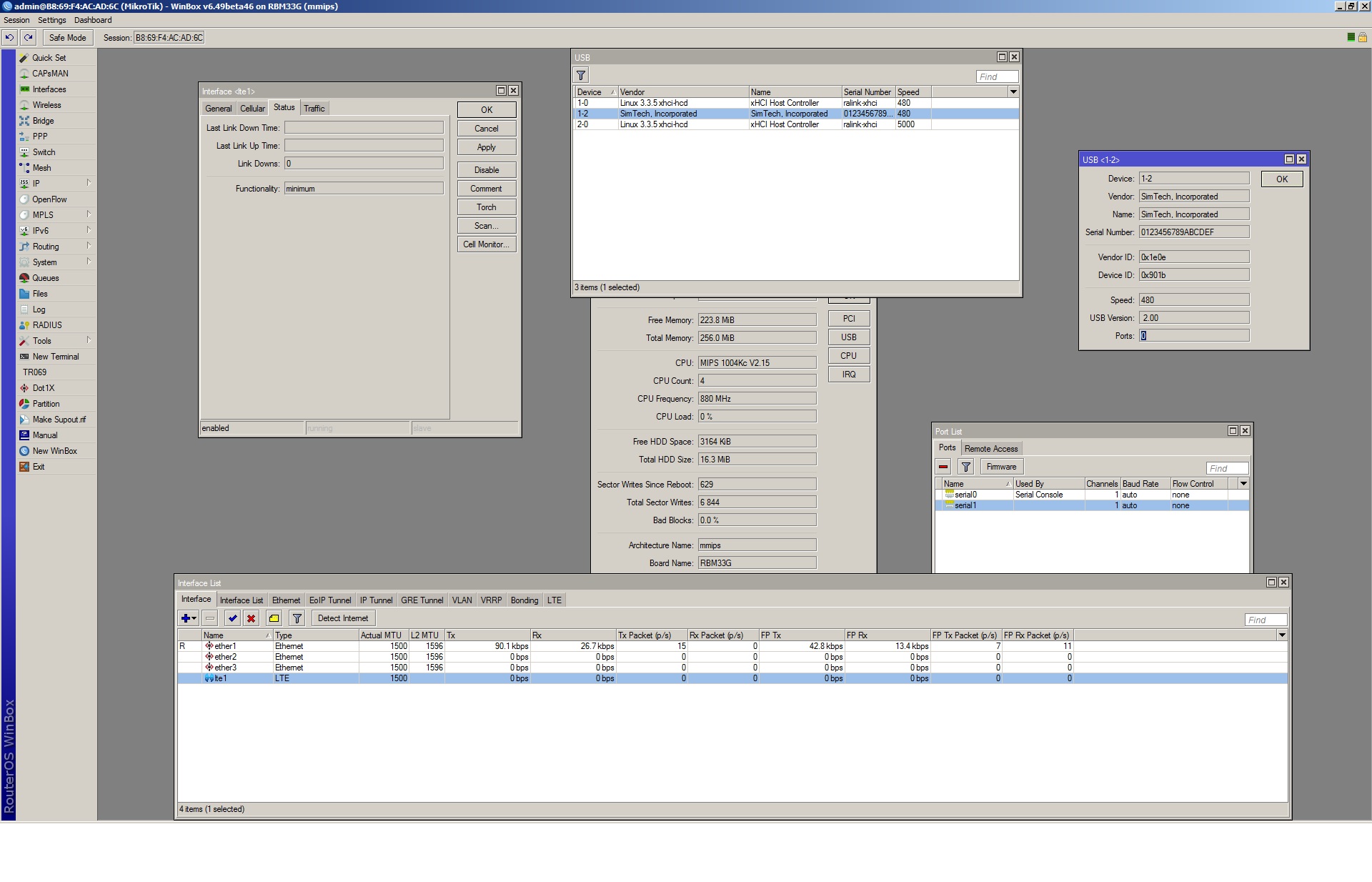

Have the same issues with the same router and modems.
Tried to switch one modem to pid9006 and now can’t see this modem as lte interface.
Version 6.46.3
Modem was switched by command from router terminal: "/interface lte at-chat lte2 input=“AT+CUSBPIDSWITCH=9006,1,1"”
Whats wrong?

Hi! I got a custom firmware from Simcom and activated the 901b mode, but the modem does not work. lte interface is created but no ports appear.
neophyte write:
but the no ports is not necessery to get internet.
R11e-LTE6 have 0 ports and works.
You probably should do now typical diagnostic… like proper APN, enable logging topic=lte, etc.
