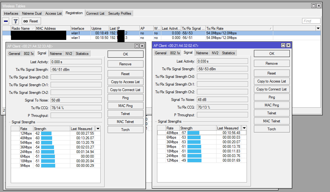

Please take a look at 2 sites ive set up to an AP. They seem to be getting quality signal, but the TX CCQ is quite low. might this be to do with the type of antenna or wireless card I am using?

To answer a few questions. I did bandiwdth tests from RB to RB and i had no increase in Tx CCQ at any stage. It stayed around 20% max. I also turned off the other radios in the area and it did improve but max was 2mbps and still fluctuating. There are plenty more radios in the area but dont belong to me; so that would make 2.4 out of the question.

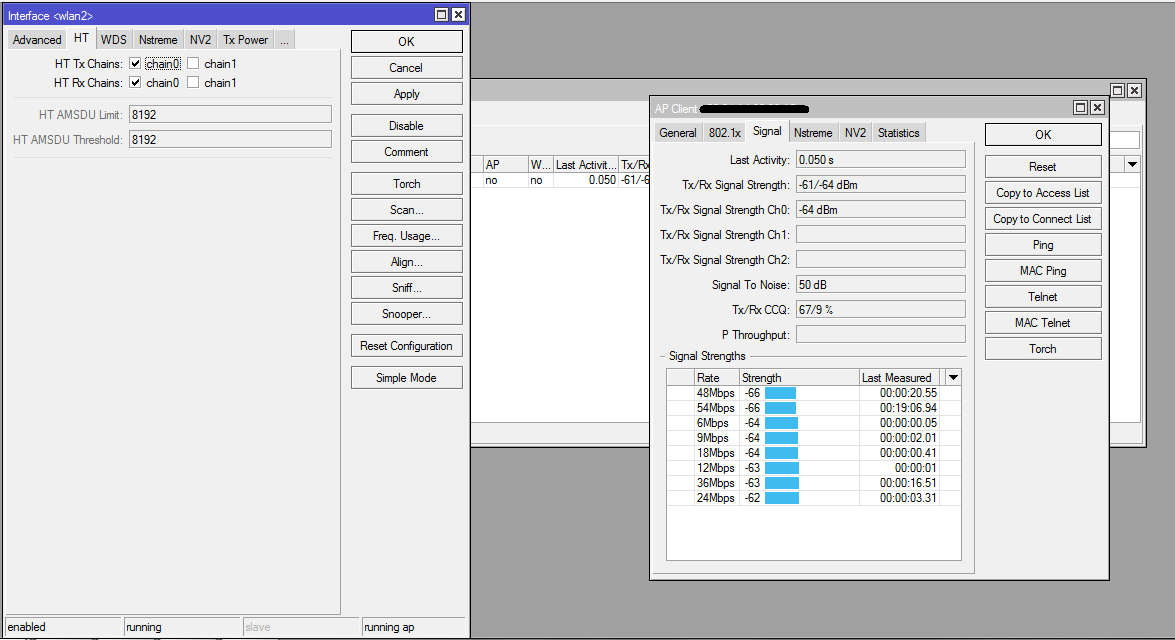

I have since tried to change from Dbii cards to R52HN and noticed a significant drop in signal values (attached). Could this just be because of the mili watts of the card?
I tried the following settings on the RBs. HT Tx Chain / Rx Chain on 0, 1 and both. I tried using 20/40 HT above. I tried using N only. I could get nothing to perform as well as the Dbii with nv2 as the only real setting change. ANY attempt on 802.11 would result in constant disconnections.
