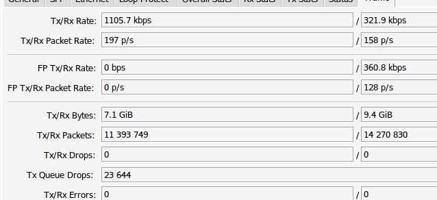

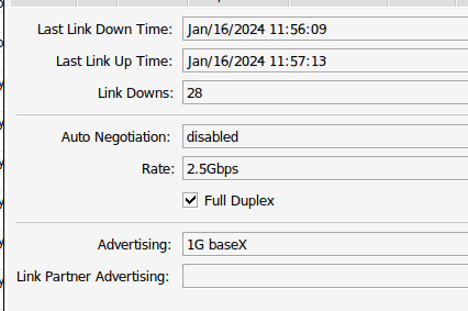

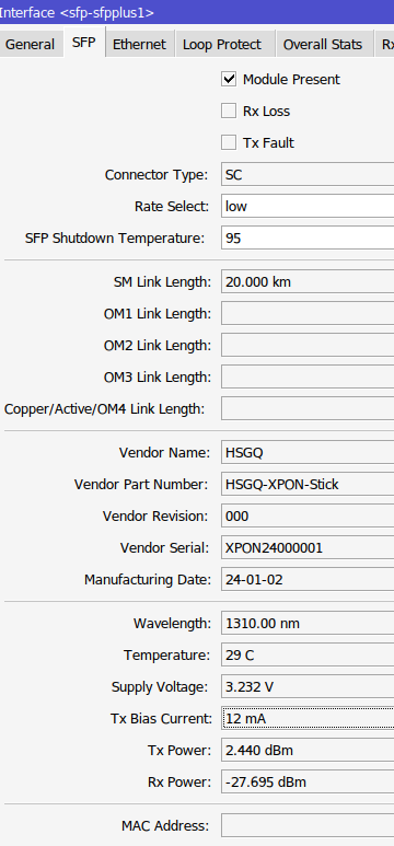

Hi, I recently bought a XPON SFP unit to use with my RB5009. It works well at 1G but at 2.5G I am seeing a lot of tx queue drops. SFP’s interface becomes inaccessible some times.

This problem is not specific to the SFP interface or the SFP module.
I have TX Queue drops on all interfaces. I am running 7.13.1 on this rb5009.
Columns: NAME, RX-BYTE, TX-BYTE, RX-PACKET, TX-PACKET, RX-DROP, TX-DROP, TX-QUEUE-DROP, RX-ERROR, TX-ERROR
 #    NAME                     RX-BYTE            TX-BYTE      RX-PACKET      TX-PACKET  RX-DROP  TX-DROP  TX-QUEUE-DROP  RX-ERROR  TX-ERROR

using mq-pfifo on the interfaces instead of only-hardware-queue fixes this problem.
