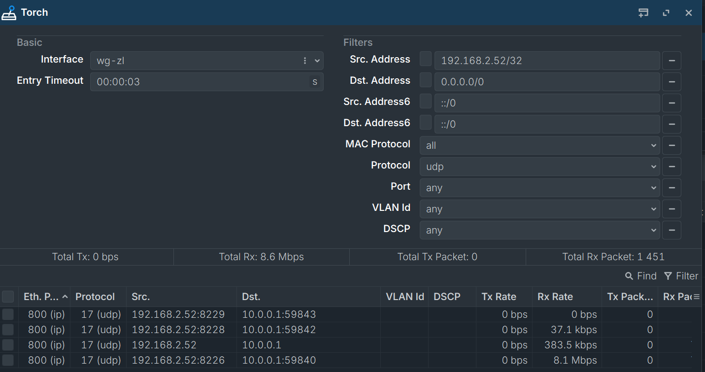

After WireGuard tunnel creation i successfully connect to Video server, my cameras are online, but I can not get the video stream.
Transport protocol is UDP and I guess there is a problem with MTU.
Is there anything I can do with WireGuard or Mikrotik to be able to see the video stream?
