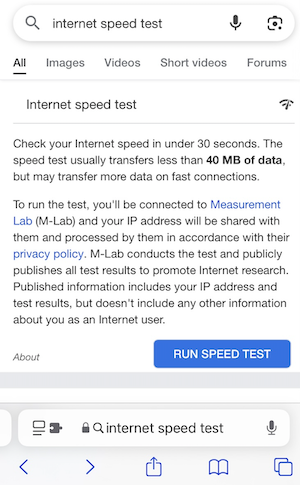

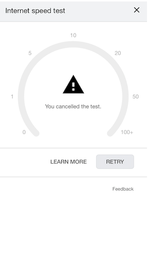

Do you get the same result with Google’s speed test (just Google “internet speed test”) when you’re plugged directly into an Ethernet port?
Yes, I just tried.
Using an old Netgear N300 Router with standard settings I Immediately get 50-80Mbits upload. Changing back to the Mikrotik - (also plugged directly to the mac) I read 5 to 10mbits/s
EDIT: and I see the same when I observe my uploads to Dropbox, my Nextcloud Server or a simple ftp connection.
