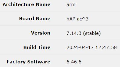

I have upgraded my Mikrotik from 6.49.10 to 7.14.3 and apparently I did a mistake.

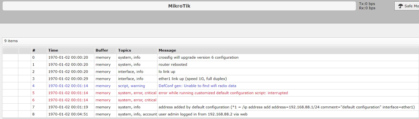

After the upgrade, the router is still responsive (considering all other posts), but cannot identify its wireless module anymore.
Attached:
-Ver - currently running router OS

Looks like upgrade switched my wireless router to wired only router. It can boot, load OS and wired interfaces, but “Unable to find wifi radio” as per log file.
Do you believe there is a way to fix this router or I simply have to buy new home router?
You can not upgrade from 6.x to 7.14 straight away.
You first have to pass 7.12 (7.11 ?) since drastic changes are present as of 7.13 (and 7.12 prepares for that so the upgrade goes automatically doing the required changes in background).
So I am assuming you used netinstall to move from 6.x to 7.14 in which case I suspect you forgot the required wireless package (which is completely separate now, not bundled anymore in the main ROS package).
Since you have AC3, you have TWO options:
  • wireless - this will restore the wireless behavior like you had it before. In GUI menus will be in wireless / wifi
  • wifi-qcom-ac - wave2 drivers. HUGE difference both in performance but also setup-wise ! In GUI menus will be in Wifi.
    See here for more info:
    https://help.mikrotik.com/docs/display/ROS/Wireless
Without one of those wireless packages, you will see Wifi in menu structure but it does not do a lot. Those are only the basic hooks (and to allow your device to act as capsman controller for wave2 devices).
Look for those packages in the extra packages for arm. Only one can be installed at the same time on your device or no wireless again.

Problem fixed:
System > packages > wifi-qcom - disable
System > packages > wifi-qcom-ac - enable. (I am running AC-device)
Reboot at the end as well.
It is kind of interesting, why device decided to use wrong package. I saw different files in packages then what was before, so I uploaded all of them within one and the same place, expecting routerOS to be intelligent enough to use correct package, but apparently it has happened the other way around.
Also need to apply new wifi names on rules under Bridge > Ports, because DHCP was not working at all.
