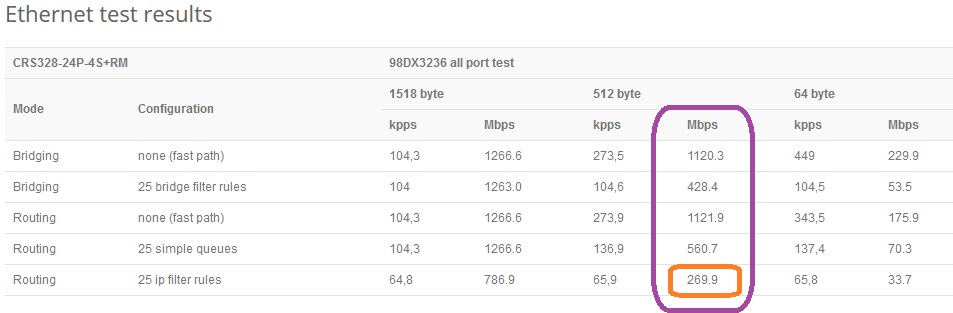

Did it ever occur to you that you bought a switch not a router. Sure it can be used as a router, RoS is fantastically flexible, but still, there are limits on throughput for WAN connectivity.
I am actually shocked that you managed to over 500 Mbps. You must not have many rules… ( dont want to see the config now LOL).
(1) /ip settings
set max-neighbor-entries=8192 rp-filter=strict
would set this to loose…
(2) Why do you have a LAN attached to the bridge? I dont see any ports using LAN??
(3) HORRIBLE idea to name your bridge= LAN, its already nomenclature used by the router for various things and its very confusing.
(4) Firewall rules are crap…
(5) Why are you mangling?? What is the requirement. Also means your fastrack rule should probably be disabled.
This can cause a real slowdown in traffic ( when fastrack is not disabled and mangling is happening ).
(6) Is your WANIP a static public IP or a dynamic public IP ??? Will determine the correct path for dstnat format.
(7) Why hairpinat? Only required for when users are using dyndns URL ( like the ipcloud mynetname) to reach the server vice the direct LANIP of the server AND
when the users are in the same subnet/vlan as the Server.
So which subnet is this occurring in???
CONCLUSION: Purchase an RB5009 ROUTER and then attach to the CRS328 via the sfp+ ports.

CRS328-24P-4S+ does not support FastTrack and NAT connection hardware-offloading (as stated on the L3HW Device Support page). Hence, all traffic requiring NAT (LAN<=>WAN) goes through the CPU, which has a limited performance because the device is a manageable switch (not a router) to begin with.

So to be clear, inter-VLAN routing on the switch can be fast-tracked? It’s only when going to WAN which requires NAT’ing that we have to go through CPU no matter what? This means that if I purchase a router, it’s only to do LAN ↔ WAN routing and not also inter-VLAN routing?
Not quite.
The Router will do all the routing bits, including
setting up all the VLANs, giving out DHCP etc.
The switch will only need to get an IP address from the management vlan, and then receive all the vlans from the router on one trunk port,
and then distribute the vlans out the rest of the ports as required. THe only vlan that needs to be identified ( as entry with interface bridge is the management vlan ).
The real power and purpose of managed switches like this is for intervlan trafffic ( not traffic to and fro WAN).
CRS328-24P-4S+ doesn’t support FastTrack offloading, but I suppose you’ve meant Inter-VLAN Hardware Routing - and yes, CRS328-24P-4S+ supports that. In other words, you should get wire speed between VLANs on CRS328-24P-4S+ (but not between WAN and LAN).
Yes, unless inter-VLAN routing requires the packets to pass the stateful firewall.
True that, so basically cross vlan traffic ( L3 firewall rule ) is what is meant here. But all traffic within vlans is more of what I was getting at.
