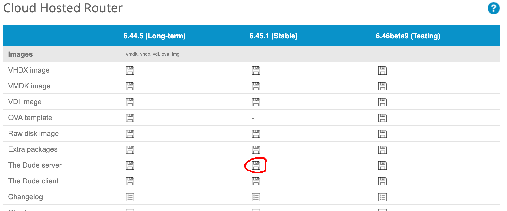

I have setup this solution prior to my RB2011 router for this dude,
1.I gotten a VPS
2. I have establish PPTP tunnels to the CHR for my RB2011 router.

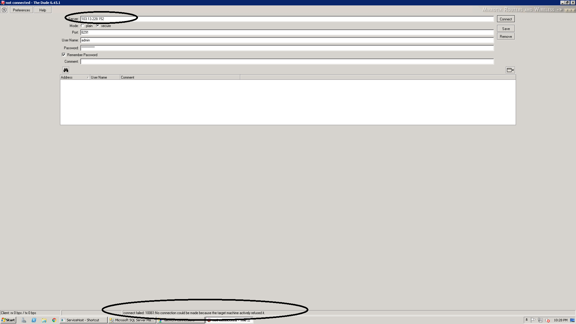

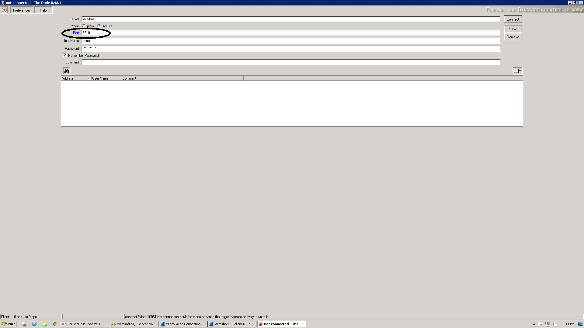

3. I have Run the Dude on the CHR but it ask me for this part on port number
So anyone has any idea on what “port” should i put it to get it working? Many thanks.
The Dude and WinBox must have the same port.
Yes, i have put 8291 as the port number, but not working as well. So what port number should i put in as?
You need to change the “Server” setting on your Dude client to the IP or name of your CHR with the Dude Server.
I tried putting ip or name of the CHR but still not working,
Go to users under sytem and check the permission of the full group. Admin should be a member of the full group
It’s kinda irrelevant when you can’t get a TCP connection, doncha think?
Did you not see the 10061 error?
