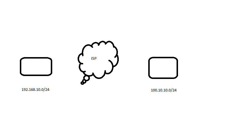

Trying to establish BGP b/w two networks although bgp established but unable to reach both lan ,Also gre tunnel create b/w both mikrotik.

Both your drawings give little clue on what is the actual issue you’re dealing with. Can you provide the current configuration exports instead? Is the BGP connection between the routers established but the routing tables are not updated, or the BGP is not up at all, or the routing tables are updated but packets don’t get through?
Thanks for replying. Actually, I have configured it on both sides by giving AS and remote IP. The state has changed to established but once I tried to reach remote lan from both ends it didn’t reach.
By the above you have responded only one of the questions, now we know that the BGP communication is established. But you haven’t posted the configurations, and you haven’t looked into the routing tables of both devices to see whether the routes to the remote devices’ LAN subnets appeared there (marked with b in the leftmost column to indicate BGP as their origin) or not. If they are there, it is a firewall issue; if they are not, it is a BGP configuration issue.
You can’t expect a useful help if you don’t provide useful input.

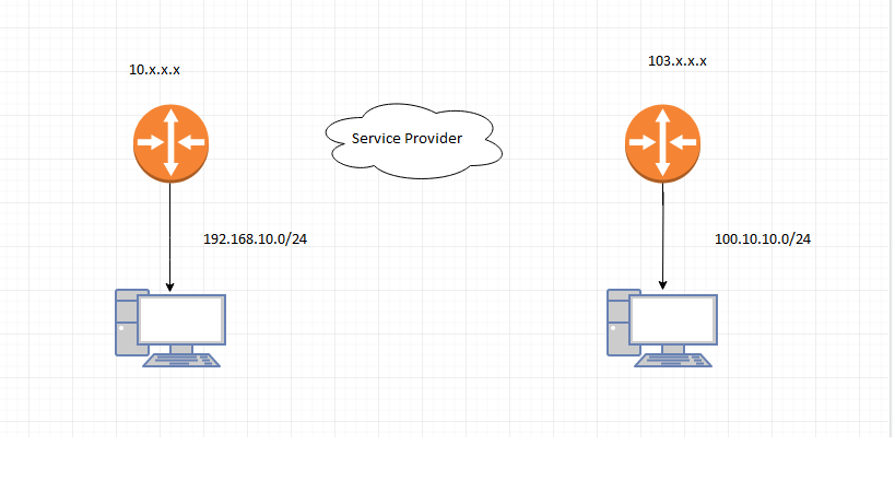

Hey thanks for ur help.Now the bgp routes are advertise in aggregation and remote ends.But still unable to reach both end. what i want is to make private network under the aggregation lan(100.127.36.0/29) and similarly at remote end under (10.x.x.x) network. So the both ends private network can be reachable.
I can reach remote end (10.x.x.x) from Aggregation lan (100.x.x.x) and vice versa. but I want to create my own private network at both end.So they can be reacable from both end.
Hopefully clarlify what I want to do.
Not really. Your drawing is not detailed enough, plus I don’t understand what means aggregation LAN.
You talk about 10.x.x.x and 100.x.x.x, but 100.x.x.x is drawn as the management network of the router at the right (where a PC is connected), whereas 10.x.x.x is a separate address next to the router at the left, where the PC is connected to a subnet you don’t mention at all. So it is not clear at all for which particular subnets/prefixes each of the two routers should advertise itself as a gateway, for which subnets the BGP advertising eventually works, and whether the advertised subnets are not shadowed by local routes with lower distance at the receiving routers.
