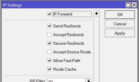

EDIT: in /IP settings there is an option to disable “Send Redirects” . [Like a Cisco “spilt horizon” but for all interfaces.] But I don’t think this is the setup you need.

For inter-subnet communication on the same LAN
using the router with “Send Redrects” disabled is a quick and dirty solution.
because:
What happens is that a router that has to forward the packet through the same interface as where it came from (the “bridge” in this case) will send a ICMP-redirect to the sender, telling the device to not come to this router again, but go directly to the next hop. The sender, if accepting redirects, will avoid the router for the next packets and fail.

Redirect shouldn’t cause this, because target will be outside of device’s subnet, so it will still be reachable only via default gateway.
I don’t know how the IP route in MT works , and how some client react on redirects.
A more detailed and more correct wording…
"The subnet is used to determine what hosts are “assumed to be on link”. If a host wants to communicate with a host outside it’s subnet then (assuming there is nothing special in the host’s routing table) it will try and send the packet to it’s default gateway.
If the default gateway knows about all the subnets and is prepared to send packets back out on the same interface they came in through then communication will work fine. Otherwise things are going to break.
When the default gateway notices that it is sending a packet back out the way it came in it may send ICMP redirect packets to inform the host that it can send the packet by a more direct route. The sending host may or may not take notice of said redirect."
