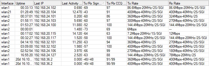

Well as explained in the white paper on 802.11n , and as the Mikrotik registration table demonstrates, the AP has to maintain the settings per client device. The interface rate is per client, the global communication from the AP such as beacons are sent at the basic-rate. So each client gets it’s own step-up and step-down actions. It can be followed in the registration table.
(Just a combined DUDE Routerinfo snapshot as example: WLAN1= 2.4 GHz /802.11n /20 MHz, WLAN2= 5 GHz /802.11ac/ 20MHz Ce. Basic rate is at 12Mbps, but initial request is always at 6 Mbps, last 2 are nv2 PtMP)
