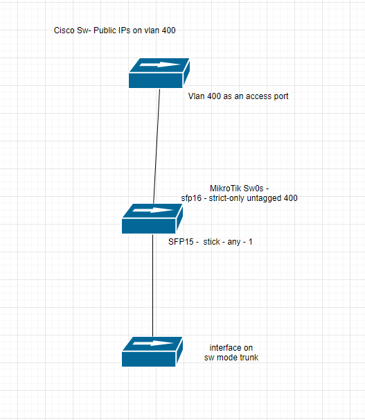

so i was trying to simulate the network i will be working on for an event. and i have a cisco 3750 that has a vlan 400 that has public IPs i wanted to pass that vlan over to my mikrotik switch on also vlan 400. from the cisco to the mikrotik i have it as an access port. and on the mikrotik set to strict. untagged only and default vlan 400. and then from that switch to a router on another port with untagged only and default vlan 400.. now from that router i create multiple vlans and went back to the mikrotik.. (all over the place i know but ive had success with this setup) now.. when i try and link another cisco switch to that mikrotik to have ALL of those vlans brought over to the newly added switch past the mikrotik.. the internet completely goes out on vlan 400 and i get this error on the cisco 3750 (headend)

why are bpdu packets crossing through the mikrotik as if it isnt even there. i had to match the link between the mikrotik and the newly added cisco similar to as if the mikrotik wasnt even there.
ill post a picture to help explain what im going through.. hopefully i didnt do to bad.

Your description and drawing don’t match, so it’s really hard to tell what you are trying to do.

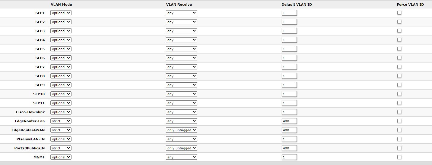

i will post more pictures to help explain what im seeing going on. basically the mikrotik switch is inbetween to cisco switches.. but the cisco switches are behaving as if the mikrotik switch isnt even there. i normally only need to keep the two switches that are directly connected to each other with port consistency. but for some reason i need to match the downlink cisco to the uplink cisco connected by the mikrotik.. totally confused..
