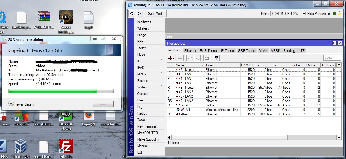

I did a quick test based on your config with some minor changes to suit my environment. I used a DHCP Client on E1 instead of PPP and different IP’s due to a conflict with yours :slight_smile:
Basically it seemed to work much as would be expected.
I did a copy from two ports on the same switch group and a copy between the two switches with the master ports bridged.
Both gave about the same speed (43MBps) but the CPU load was different.
A CPU load of 2% when copying between ports in the same switch:

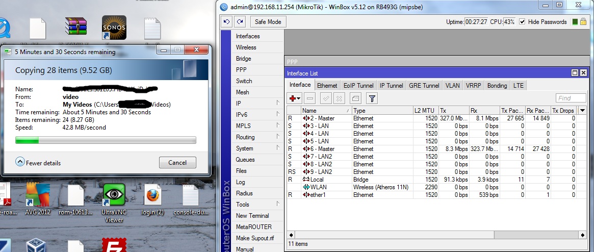

and 40+% when copying between the two switches via the Bridge:
You should also note the throughput on the port speeds as well. The traffic does not show at all when copying between ports in the same switch but does when you go through the bridge.

Be sure to also check /system routerboard and ensure latest FW is running :slight_smile:
So the lesson to be learned for today is that if you really need a switch, buy a dedicated one. :laughing:
Hmm, interesting results. CPU is same as what I see. Actual throughput is not. Using latest firmware.
Will try same test on a different board and see if itv is something uniquely flaky with that one.
