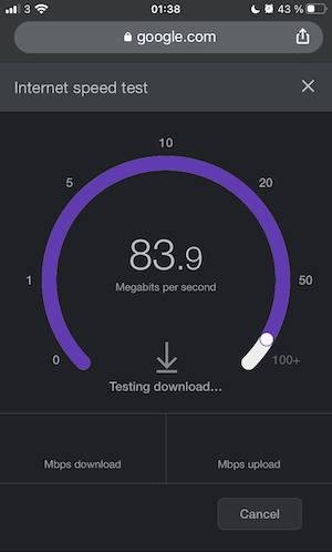

Also be aware that some test services might give different results depending on whether they use tcp, udp and how much it loads the device.

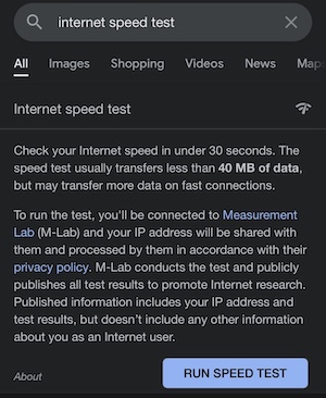

When I don't have access to specialized test equipment I usually prefer to use the google built-in internet speed test whenever it's available (google "Internet speed test") which is fast with a minimal load and startup time on mobile devices:
