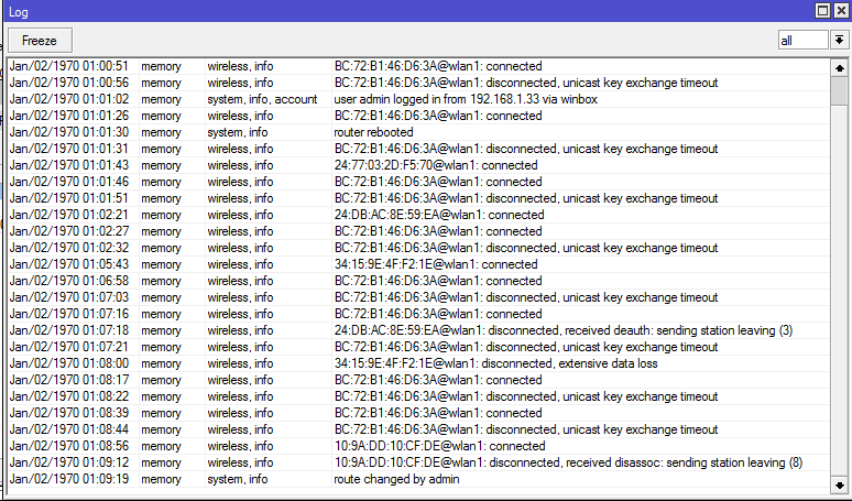

I have a RB951-2n acting as an AP. Works fine.
Recently I bought a new Samsung phone, and I wanted to connect via WiFi to the router. After entering the password, I was “kicked out” by Samsung, and could not connect.
When I used my PC to connect (works fine through WiFi), I checked the log. I see it is connected, and 5 seconds later it disconnects with “unicast key exchange timeout”. And that happens every time.
I did not know what it was, so I Googled it. Not much to find, only “old” topics (2008) about this problem in pre 5.25 version of the OS. This AP was running 5.25, so I immediately updated to 6.2. No difference.
What can this be? Hardware incompability? In the attachment you can see the screenshot.
Haik
P.S. All existing topics about the unicast problem have issues with iOs of Apple. This is a Samsung with Android 4.1
