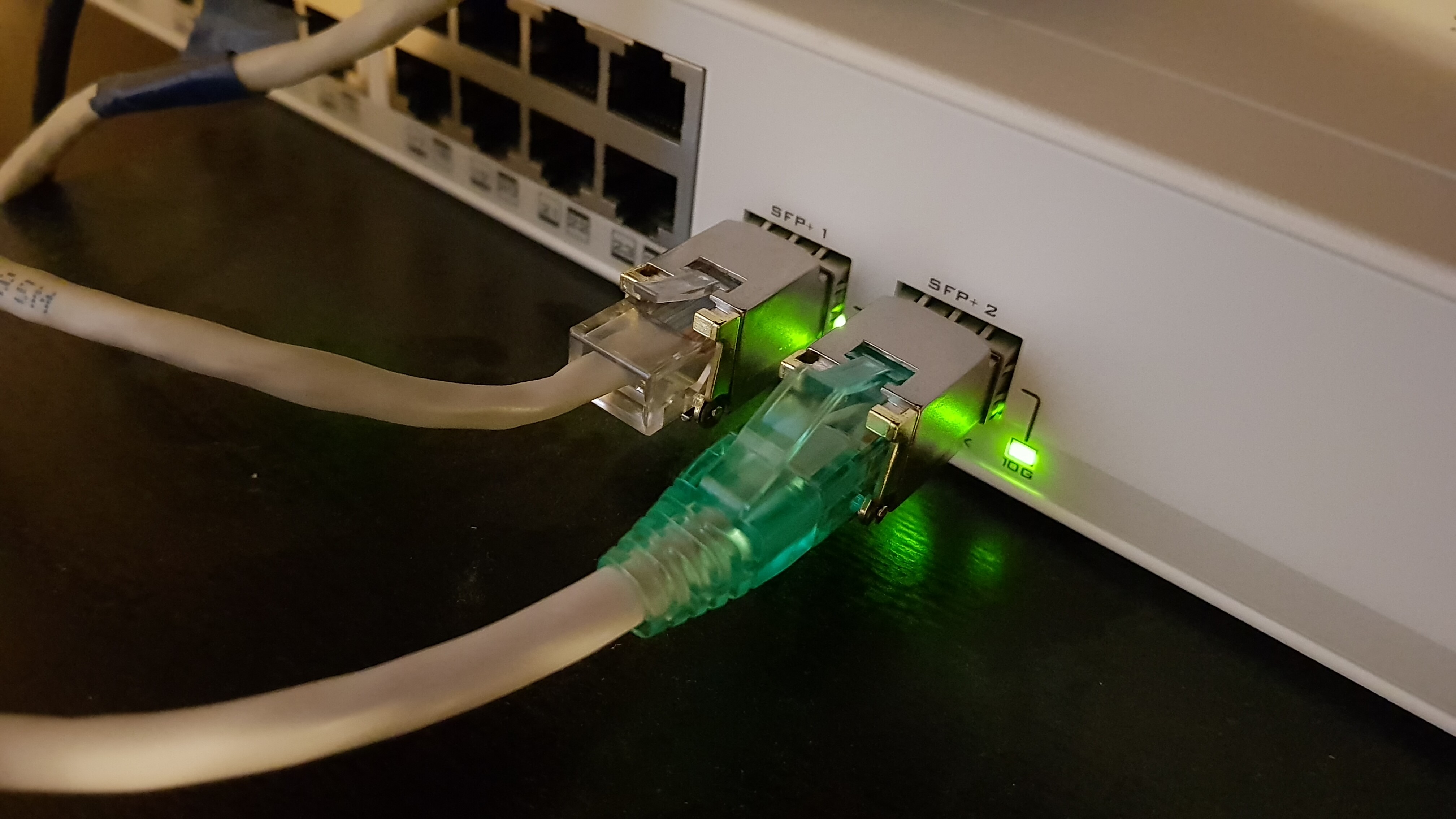

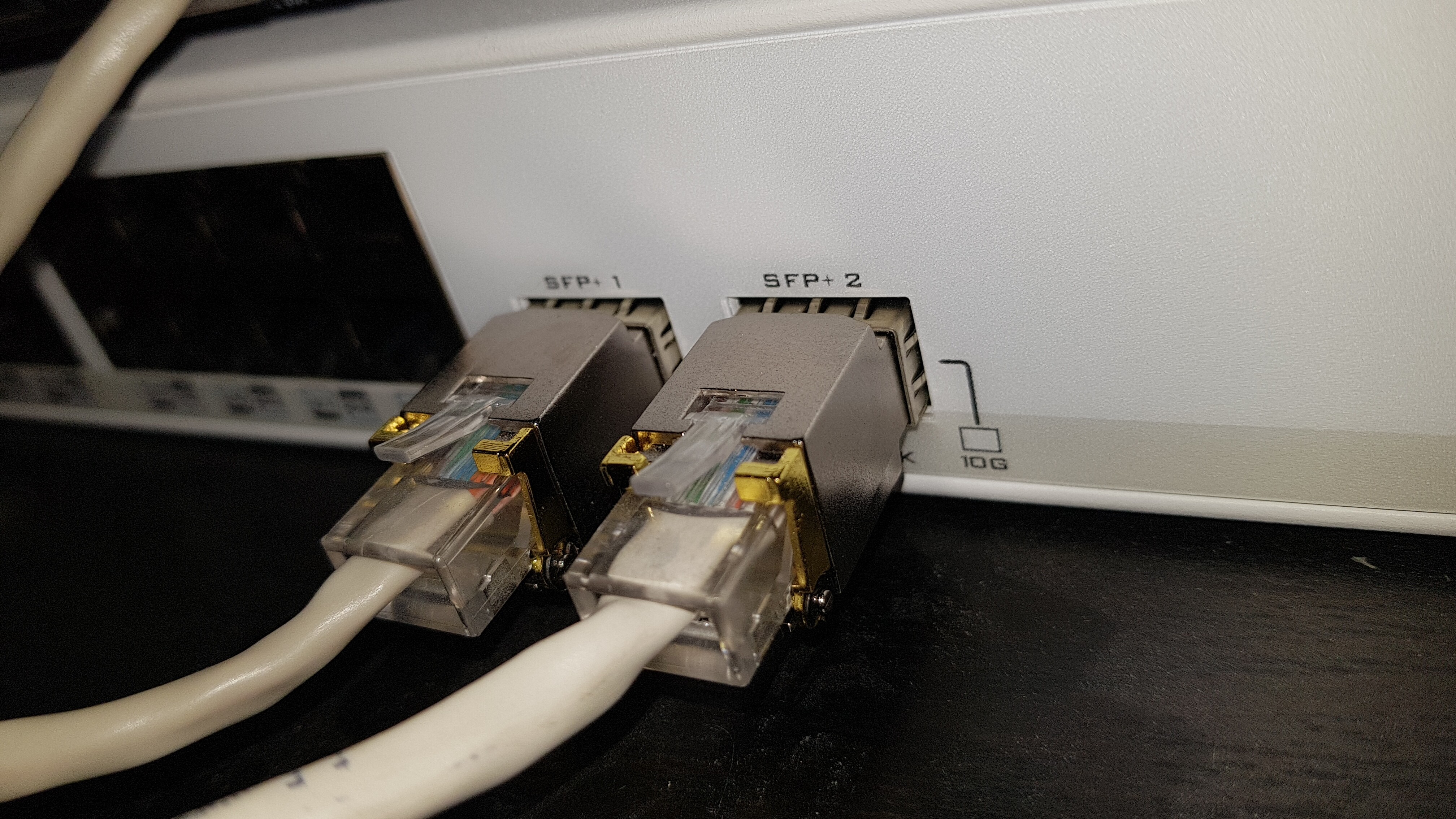

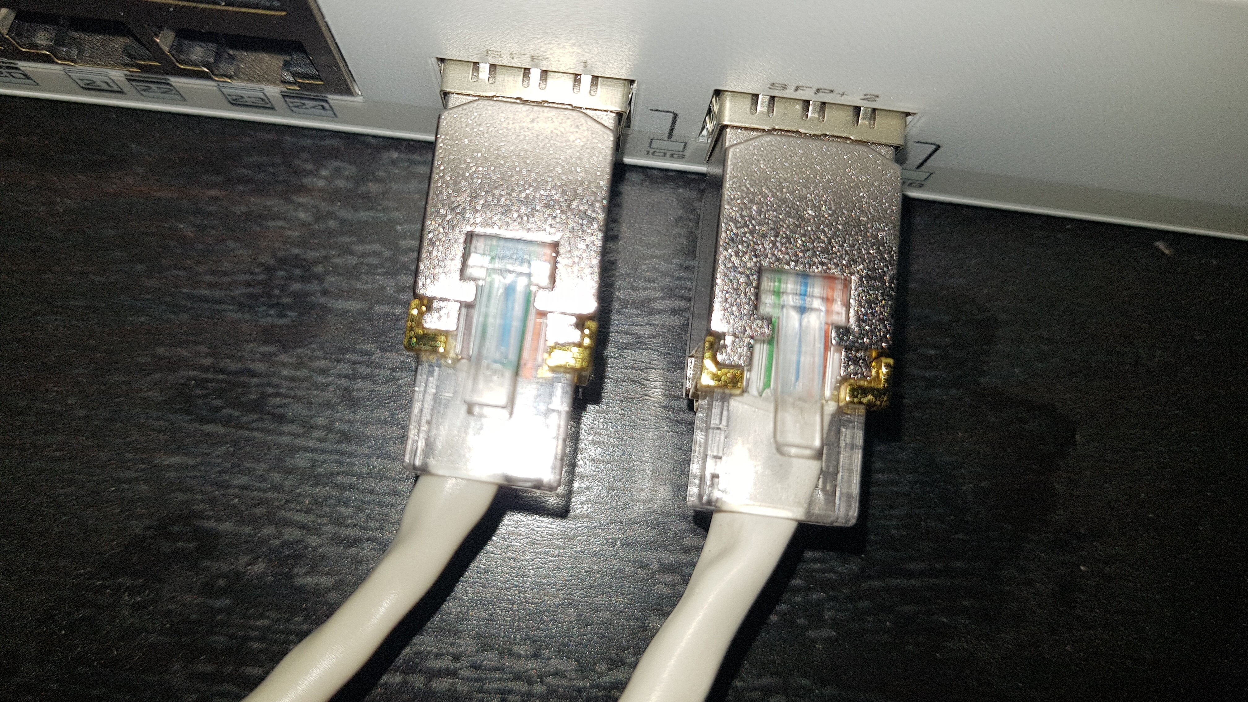

Apologies if I’m stating the obvious, but have the modules actually locked into the SFP ports ? They should click when you push them in and should require the gold lever to be opened in order to remove them. Also do your ethernet cables have rubber boots on could be preventing them from locking into the modules properly ?
Does the connection drop when you touch the middle of the long cable, or just near the SFP modules ?

I cannot say that they click, but there is something close to click when I insert them. Gold lever is required to be opened in order to remove them. There are no rubber boots.
Connection drops when I touch near SFP modules.
I added photos to the post.

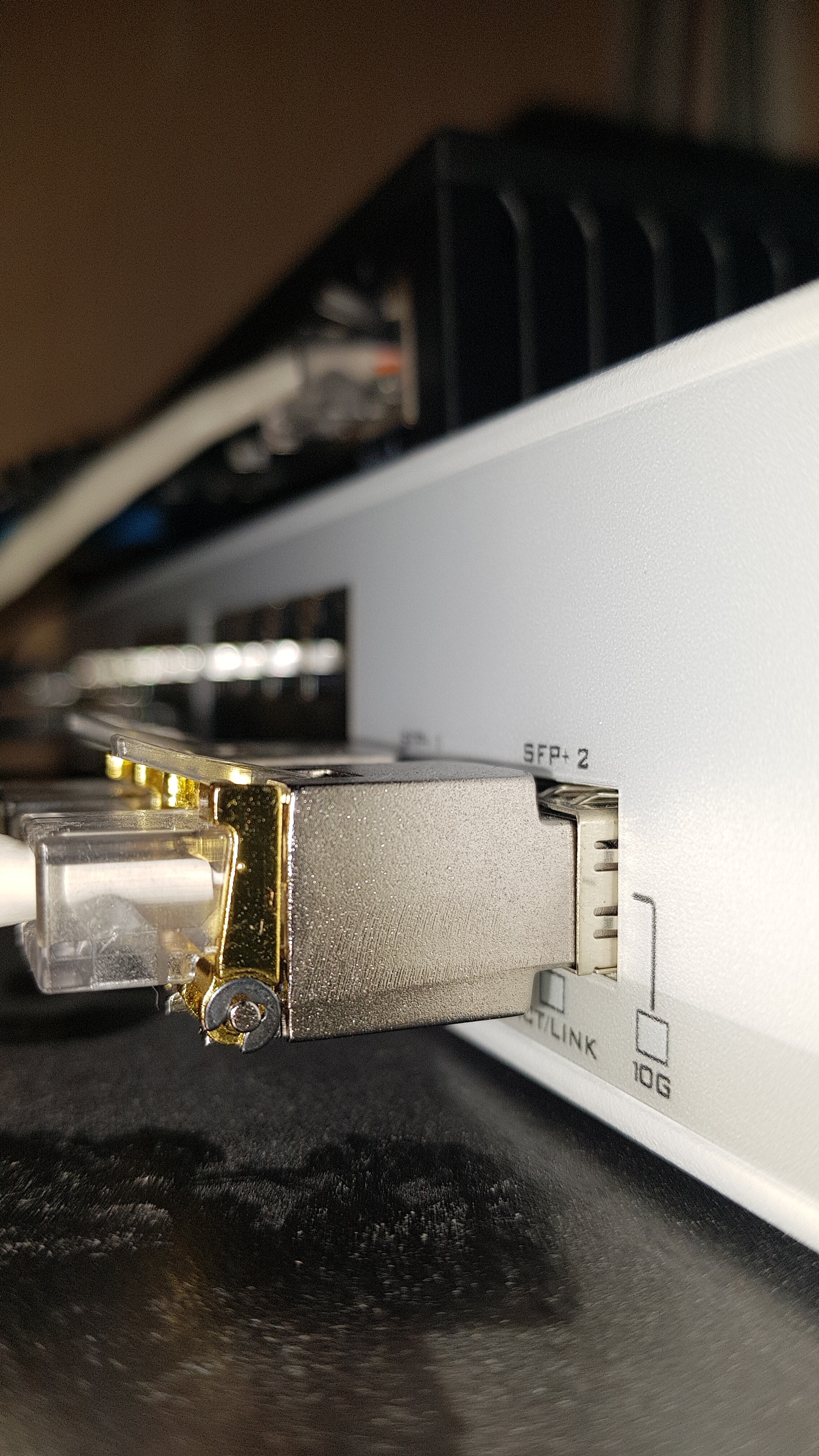

It seems that the issue was fixed by replacing cable with Category 6A patch cord. I will do more testing later.
You can see replaced cable on the front. I will replace the second cable later:
