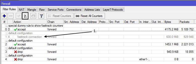

Default settings with HomeAP mode set. My goal is to throttle connections back to 256kbps and turn off internet on specific devices during the evenings. Simple Queue should take care of this but it isn’t working. Attached image simple queue is a device with a statically assigned IP in a queue rule.
The attached byte graph is not showing all the bandwith going to the device, I am running speedtests from speedof.me and getting waay over the 256kbps (32KB) up and down.
I have tried changing the queue type from default-small to wireless-default and that is not helping me achieve the desired effect. Reboots of the router have also been done after changes to have the clients re-associate.
My guess is the simple queue is not catching all the traffic the device is sending/receiving because it is only listening on the LAN interface, not the wlan1 interface…
Is this a known issue? Does anyone know why I can’t get the simple queue to work with the wireless clients? Any help appreciated.
Thanks!

Hoping with a post of the config someone may notice an issue that would cause the simple queue to not work.
It seems that only some of the traffic is being monitored when bringing up a client in the simple queues.
Thanks for proofing the config!

add action=fasttrack-connection chain=forward comment="default configuration" connection-state=established,related log-prefix=""
add action=accept chain=forward comment="default configuration" connection-state=established,related log-prefix=""
add action=drop chain=forward comment="default configuration" connection-state=invalid log-prefix=""

pe1chl
August 15, 2016, 5:01pm
9
Did you disable fastpath and fasttrack?
akwire
August 15, 2016, 6:21pm
10
Thanks for the reply! No, I don’t believe fasttrack is disabled just by reading through the config.
If this could be causing my issue with the Simple queue not being enforced, what commands should I run to disable both ?
Reading the http://wiki.mikrotik.com/wiki/Manual:Fast_Path it says that fastpath will be enabled if specific conditions are met, could fastpath nullify my simple queue rules?

akwire
August 16, 2016, 3:59am
11
I disabled the second rule in the firewall pertaining to the fasttrack connection and the simple queues are being enforced .
Thanks for the solution. Is this a known issue that has been brought up in other threads? If so, please reply so others can learn about this configuration resolution.
