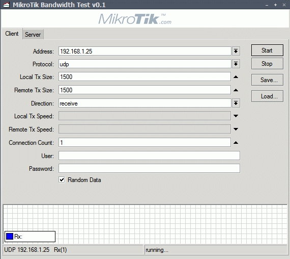

However after a quick test, it doesn’t seems like it’s working correctly:
If local Tx/Remote Tx speeds are not set, it will just not do anything (if using direction=receive):

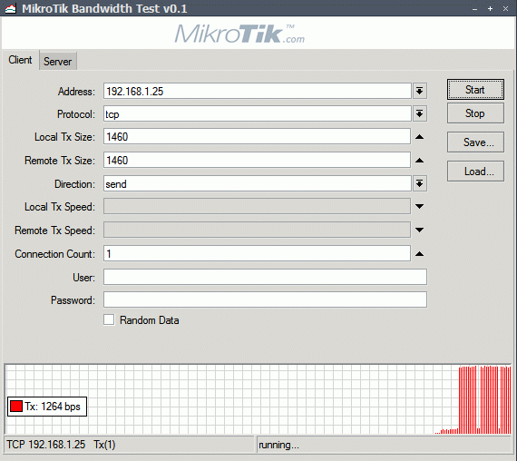

If direction is set to send, it starts sending data but at very low rate like 1264bps and never goes above that:

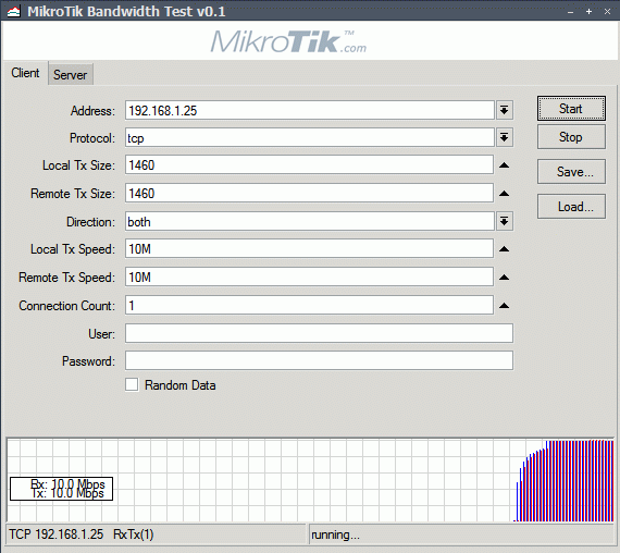

With speeds set manually, TCP testing is now working well:

All testing done between directly connected PC and RB800, link at 1Gb/s. Router CPU never went above 50%. Using no firewalls or any software that would prevent it from working.
Small update:
Local Tx and Remote Tx speeds just must not be grayed out. If you set them to 0 bps, btest will automatically ramp up the rate and now everything works.
