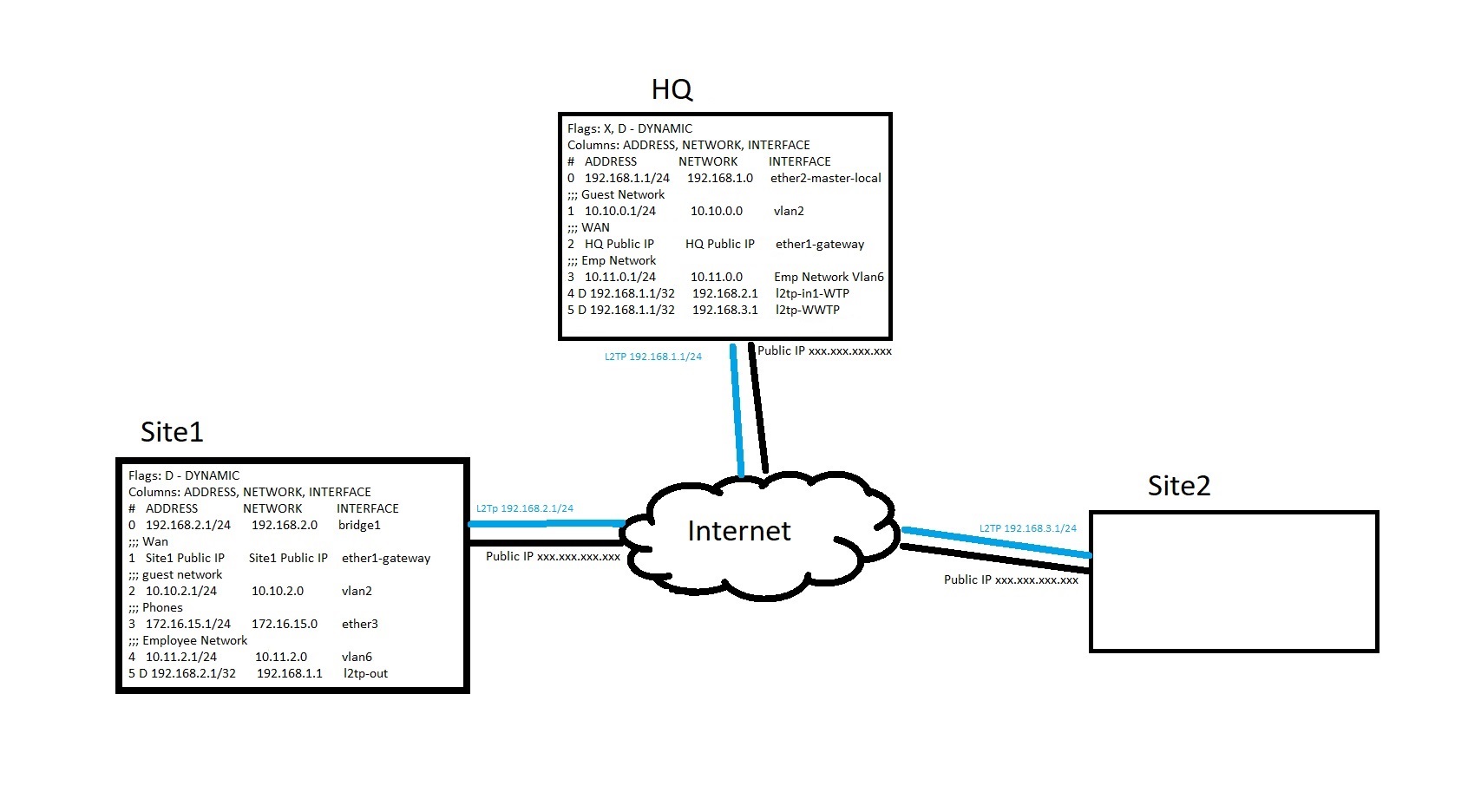

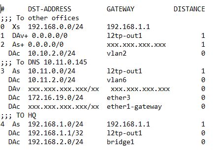

I have Phone that are on 172.16.19.0/24 and computers are on 192.168.2.0/24
The computers are going thought the L2TP which is right. But the Phones are going thought there to.
The Phone should be going right to the internet not thought the L2TP tunnel. How do I get the Phone to go right to the internet?
bridge1 192.168.2.1 (bridge1 has ether2, 4 and 5)
Ether3 172.16.19.1/24
All help is appreciated.

As someone has pointed out in the first thread you’ve linked, VRF in Mikrotik is just another way of assigning the routing mark (routing table name) - you define each virtual router by a list of interfaces that belong to it and the routing table name. What RouterOS does is that it assigns the routing table name to use to a packet as soon as it enters it via an interface (and if you attach an IP subnet to an interface, the route to that connected subnet is automatically added to the corresponding routing table).
As this apparently doesn’t work in ROS 7, you have to assign the routing marks some other way. The simplest one is to use routing rules:
/routing/rule
add src-address=172.16.19.0/24 action=lookup-only-in-table table=via-ether1
add src-address=192.168.2.0/24 action=lookup-only-in-table table=via-l2tp
and, of course, you have to add the corresponding routing tables, each containing only a single default route via the correct gateway.

Maybe I’ve misunderstood the requirement. My understanding was that the computers and phones are connected to a different LAN subnet of the router each, and you want each group to use a different “WAN” of the router (one of the WANs actually being an L2TP tunnel) to get to the internet.
If you had in mind that the PCs and the phone were L2TP clients, and you want the phone to access only the LAN subnets of the router via L2TP but get to internet directly, not via the tunnel and the router, I don’t know any mechanism allowing that in ROSv6 with L2TP on a phone, so I don’t get how that could be working before unless controlled by a setting at the phone client.
Sorry I should have explained better.
So we have 1 HQ and 2 site or offices if you want to think of it that way
Both site connect to HQ using Mikrotik Routers (RB750G r2) so the tunnels are established using the routers.
The phones are IP phones using VOIP.
Before we upgrading site1 The IP phone were going out right to the wan port. But after the upgrade now everything is going thought the L2TP tunnel witch would be fine if the internet was more reliable.
I had to put this in on the HQ Router to get the phone to work since they want to go through the tunnel
add comment=“Site1 Phones” disabled=no distance=1 dst-address=172.16.19.0/24 gateway=192.168.2.1 pref-src=“” routing-table=main scope=30 suppress-hw-offload=no target-scope=10
So it turns out I did get it right initially after all, i.e. that the OP describes the requirements on Site 1 and/or Site 2 where the intention is that the phones use the local gateway to get to the internet whereas the computers either do not get to internet at all or use the HQ’s internet connection?
But then this may be the key question - are the computers supposed to get to internet at all, or can they talk only to the HQ (and maybe use a http proxy there to get further to the internet)?
Because if a computer should ping an address in the internet via L2TP, but a phone should ping the same address in the internet directly via a WAN gateway, there is no other way than to use two distinct routing tables and some rules that determine which of the routing tables to use based on something else than the destination address alone - in particular, in-interface or src-address.
So I can ony imagine it worked before by mere routes in a single routing table (i.e. with no need for routing marks) if the default route was via the WAN gateway, and routes to all private ranges were via L2TP, whilst the phones didn’t need to talk to private ranges whereas the computers didn’t need to talk directly to internet.
Could it be that simple?
If so, the only thing you need is to set add-default-route to no in the /interface l2tp-client row, so that it would stop adding a default route via itself. Which probably was like that in 6.x, and the configuration conversion might have broken it.
@sindy
And yes the computer to get internet and use HQ internet connection.
And the computers can ping each other via L2TP.
I will try to go to those site tomorrow and set the default route to no. Just in case it breaks and I can turn it back on.
I will let you know what happens.
@Sindy
That fix it.
Thanks your help. :smiley: :smiley: :smiley:
