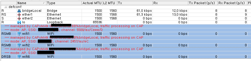

I went ahead and did it (upgrade that is), devices are connecting and network is up but when I login to CAPsMAN (using winbox) then go to WIFI → WIFI (tab) I do not see and Tx and Rx moving.
It’s displaying 0.
I get a RED error message saying “operated by CAP %ether1, traffic processing on CAP”
What do I need to do to see individual Rx Tx stats?
Stats are only available on the CAP itself, not on the CAPsMAN.
The “RED error messsage” is actually not an error, you can ignore it.

Can you tell me where in CAP I can find it? I’ve looked everywhere and can’t see it.
If you are referring to WIFI ->WIFI (tab). No it is only showing 0.
Traffic on the interface tab.
I’ve included a screenshot of the interface window.
You can see the 3x WIFI interface showing Rx/Tx 0.

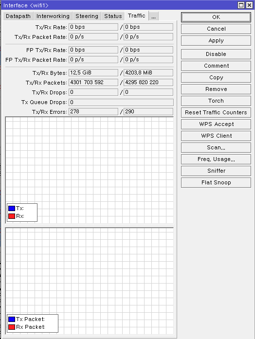

Go to wifi, open the wifi interface, select traffic tab.
I think you mean this. See attachment.
It also shows 0. However, while I took this screenshot, I noticed that the values of Tx/Rx Bytes were not changing, though they have a non-zero value, which I can’t comprehend as the Tx/Rx rate being 0 all the time.
How is it possible for it to accumulate that size with a rate being 0 all the time?
Am I missing something here?
Could you try with Winbox 4.0Beta18?
Thanks. It works with 4.0 Beta18.
