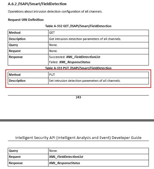

I have a similar problem, I can read a file using the Hikvision API,
 > /tool fetch keep-result=yes url="http://admin:password@192.168.0.155:80/ISAPI/Smart/FieldDetection" mode=http dst-path="DetectionON.xml"
but I can’t write it using the Hikvision API manual.
FTP also does not work, there is information that Mikrotik does not support sending files via HTTP / HTTPS and suggests using FTP
Unfortunately at the moment fetch does not provide such option to send files over http/https, for this you have to use FTP.

How to implement file upload? Help me with the correct spelling of the appeal to the API with sending the file to the Hikvision video camera.
curl -T works for everyone, but here it is unclear how to implement it.
