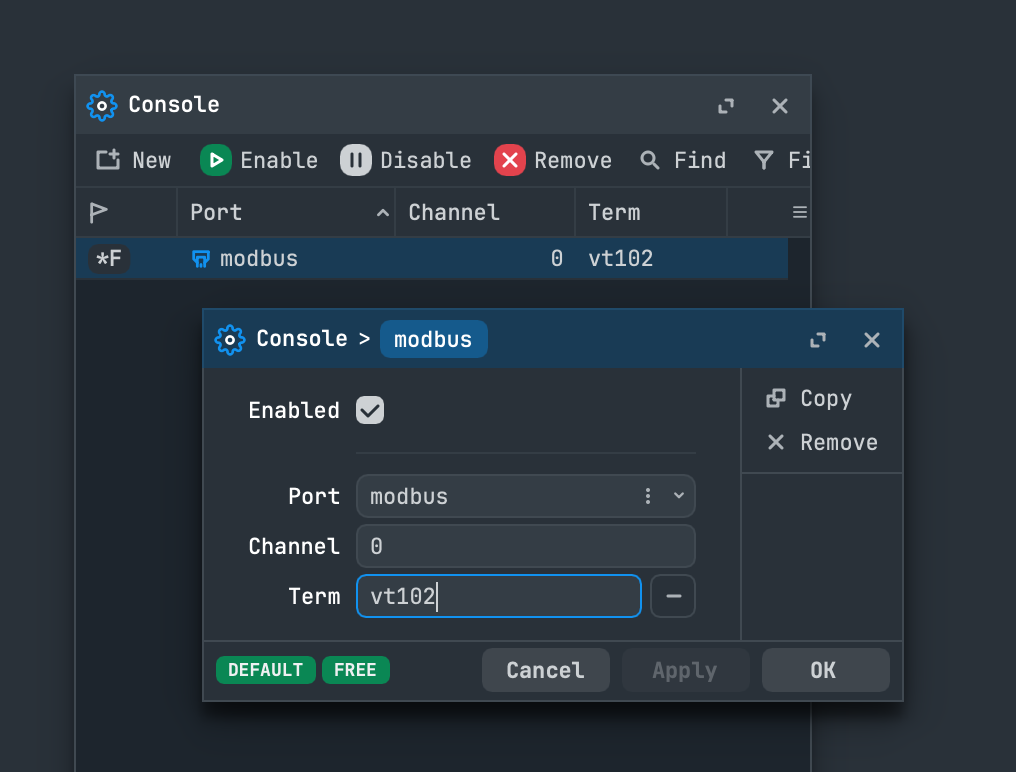

That's true.
But curious though is that it does let assign modbus as a /system/console. I don't have any modbus things to analyze what happens... but AFAIK providing a "serial console" is not how modbus works.
The KNOT RS485/MODBUS interface is a regular UART, the big difference is that line interface is half-duplex controlled by the UART handshake or some other CPU-controlled I/O pins.
Protocols utilising an interface like this are designed either with a master device initiating communications with the recipient responding a set time interval after receiving a message from the master, or by listening to what they send on the bus to detect collisions so they can retry some time later.
If the KNOT hardware automatically enables the RS485 drivers whilst the UART is transmitting data and the device at the other end can likewise control the TX/RX mode of an RS232/485 converter it might work as long as the two end do not send data at the same time - unlikely for generic terminal access.
