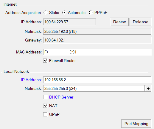

Just reset the hAP ax lite one more time and in the Quick Set disable DHCP Server and set IP Address to 192.168.88.2.
Use ports 2,3 or 4 on hAP ax lite for connecting to the hAP ax3. From now on both devices are in the same network and you should be able to manage hAP ax lite while being connected to hAP ax3.
Connect to hAP ax lite and set the same Wi-Fi name and password as you have on your hAP ax3, if you haven’t done so in Quick Set.
Also set DNS server on ax lite (in IP → DNS) to 192.168.88.1 or some public ones (1.1.1.1, 8.8.8.8, etc.) and add a default route (IP → Routes, dst-address=0.0.0.0/0, gateway=192.168.88.1) to let ax lite itself access the Internet.

That is not a CAPsMAN way, but a manual setup of the access point with a static IP address. To make things simple I would not use CAPsMAN in case of just one access point.
You can keep default settings under “Internet” which is “Automatic”. These settings are applied to port 1, and you won’t be using it. The IP needs to be set under “Local Network” and you will use this IP in WinBox or WebFig to manage the AP once it is connected to hAP ax3.
