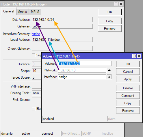

When you normally setup your LAN/VLAN interface by adding a /24 entry to /ip address, such as this:
The exact same thing happens. The 192.168.1.0/24 route is constructed as above, and packet sent to addresses within that subnet are routed through the bridge interface. And the router use 192.168.1.1 as its address on bridge. The only difference is that when you use a prefix length smaller than /32 the router will automatically adjust the network address based on the value of the address field and the prefix length.

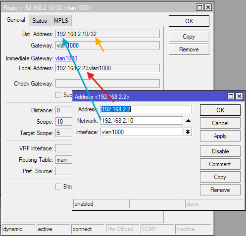

But if you only need to communicate with one single device over an interface, even if that's an ethernet interface (not PPPoE), you can of course only add an /32 address to the interface under /ip address. Because you only need to talk to 1 remote host, a /32 route to that exact address is enough. And that route will be created if you specify that remote host as network address and chose /m to be /32.
Here is an example on my router, that has a SFP GPON stick. That stick has a management interface at the address 192.168.2.10, and on my router the interface is vlan1000 (an ethernet interface). I can add an address entry so that vlan1000 has the whole 192.168.2.0/24 subnet, but I don't have to, and don't want to, because there's only that GPON admin interface I want to talk to. So I add the address entry on vlan1000 like this:
So when I enter http://192.168.2.10/ in my web browser, the router knows that it has to look for 192.168.2.10 on the vlan1000 interface, and because that interface is in the WAN list, masquerade is applied and the GPON device see incoming packets with the router's address 192.168.2.2. If I try to connect to 192.168.2.8 or 192.168.2.1 or 192.168.2.100 then the router won't try to use this vlan1000 interface, but will use my default 0.0.0.0/0 WAN route instead.

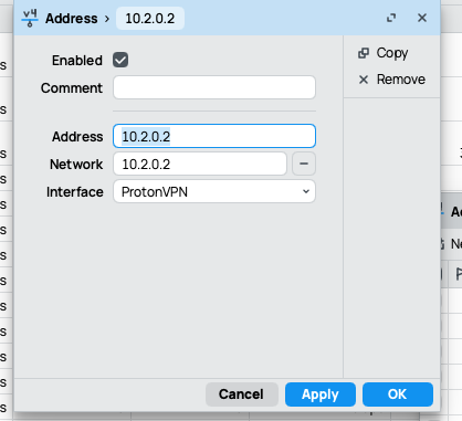

add address=10.2.0.2/32 interface=ProtonVPN network=10.2.0.1
@NA9D please note that the network address is 10.2.0.1 and NOT 10.2.0.2 like in your screenshot!

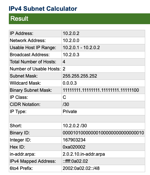

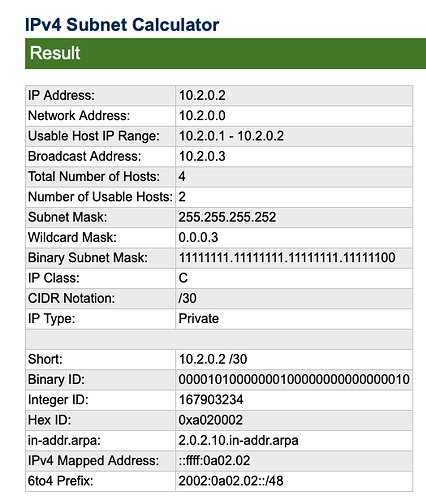

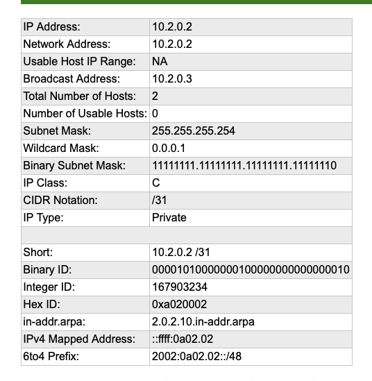

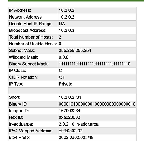

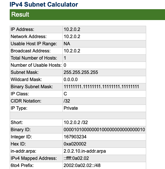

I don't think you are correct. In a 32 bit network there is only ONE address in this case 10.2.0.2. There is not separate network address.
Images from: https://www.calculator.net/ip-subnet-calculator.html
To have 10.2.0.1 be the network address is actually not possible. Because in a 31 bit network, you have two Ips - 10.2.0.2 and 10.2.0.3 and .3 is the broadest address. 10.2.0.2 is still the network address:
If you make it a 30 bit network, your network address becomes 10.2.0.0:

add address=10.2.0.2/32 interface=ProtonVPN network=10.2.0.2
The added route has destination 10.2.0.2/32 which is a useless route. You can see this route right now in the IP -> Routes table if you configured the router like that.
Because the router has the 10.2.0.2 address already and doesn't need to know how to reach 10.2.0.2. In fact, it will use the lo interface (the loopback interface) when talking to 10.2.0.2 (itself) and not ProtonVPN so this route entry is nonsense.
And now the router doesn't have a specific route to 10.2.0.1 at all (again, look in your current route table). If you ping 10.2.0.1 right now it might try to use the default 0.0.0.0/0 route.

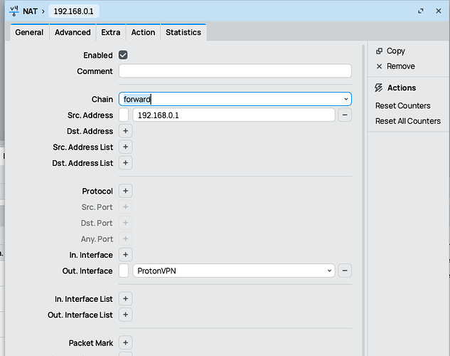

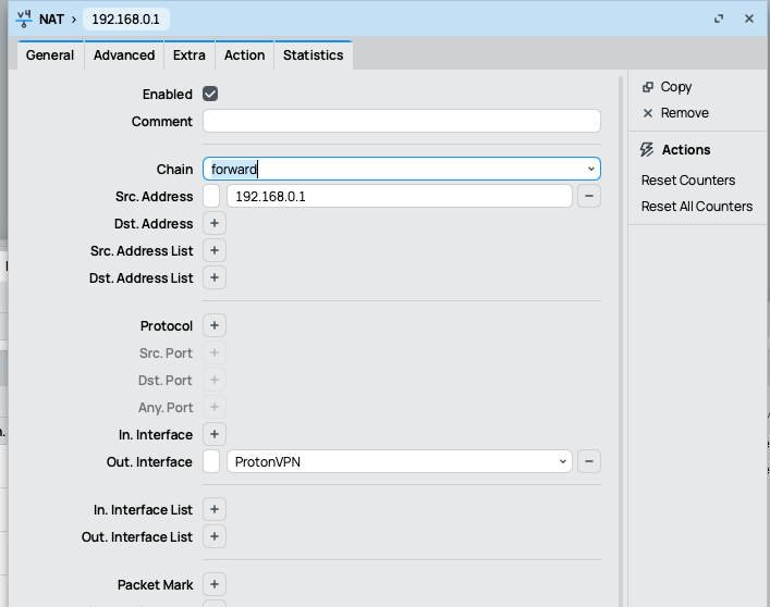

OK. Now, I have a new question related to this.

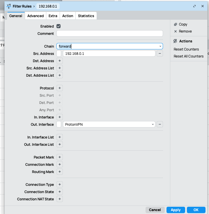

I want to create a firewall rule to send all traffic from a specific LAN IP address to the ProtonVPN.
This morning I created a NAT rule as shown below:
It seemed to be working fine and doing what it should. And then it stopped working. I've tried to add a firewall rule of the same.
Still not working. Not sure why it was working and now it isn't. I want to send all traffic from 192.168.0.1 (or any specific LAN IP) to the ProtonVPN connection and prevent it from going over the normal WAN connection.
Where am I going wrong?
It's not done with NAT rules like that. You can remove that rule that you've added.
