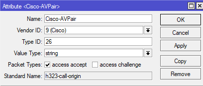

However I am having trouble using user-manager with our Nexus switches. I can authenticate to the switch, but it is hard coded to give me write only ‘network-operator’ privileges instead of ‘network-admin’ privileges by default. And I need ‘network-admin’ privileges(or ‘full’ privileges in Mikrotik terms). As far as I know there is no way to chenge this default. However it is possible to get those privileges by pushing a RADIUS attribute. The RADIUS attribute is supposed to be called ‘Cisco-AVPair’, I think?
So far I have configured it like this(attachment picture 1). I don’t know if this is correct, can you help? Code:
/user-manager attribute
add name=Cisco-AVPair type-id=26 value-type=string vendor-id=Cisco
And I have configured the RADIUS user like this, obviously redacted:
/user-manager user
add attributes="Cisco-AVPair:= \"shell:roles*\\\"network-admin vdc-admin\\\"\"" name=XYZ shared-users=unlimited
Picture 2 in the attachemnt is this… Also I don’t know if this part is correct either.
