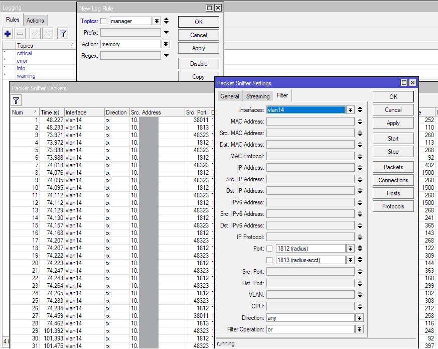

In System → Logging you can add an entry for the “manager” topic to better diagnose the issues with your Cambium AP. You can also use the Packet Sniffer on the router (filter by UDP ports 1812, 1813) to monitor the RADIUS communication between the AP and the router.

If you add the new entry for topic=manager under System → Logging, you’ll see more details in the Log whenever the APs communicate with User Manager. Also you can temporarily start Tools → Packet Sniffer (configured to filter ports 1812 and 1813) and check whether packets appear on the router interfaces when the APs are supposed to send the requests to User Manager. Packet Sniffer can also dump to file, and you can open the file in Wireshark to see all the protocol details from the packets, including what response is sent back by User Manager.
If nothing appears then maybe a firewall is blocking UDP packets between the devices and the router.

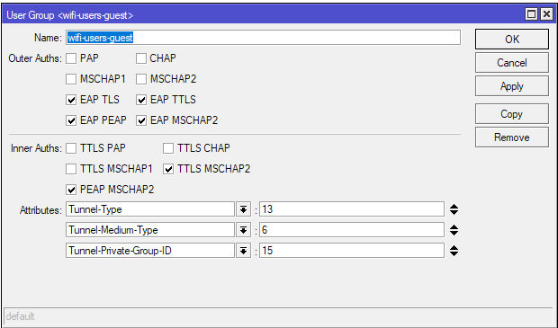

You can also create special user groups for your WiFi users, for Outer Auths and Inner Auths only these checkboxes are needed.
In the screenshot you can also see that I am assigning the WiFi users belonging to this group to the VLAN with ID 15, by adding the three attributes. The VLAN ID is specified with Tunnel-Private-Group-ID (15 in this example). Your access point must support this feature, I’ve confirmed it working with UniFi, Aruba, and TP-Link Omada APs. With this you only need one SSID but can still have the connecting users in multiple different VLANs. The ethernet port from the router to the APs must be configured as hybrid ports with the supported VLANs tagged.

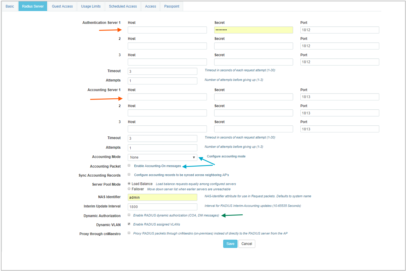

If no packet appears in the packet sniffer, and no log is being written in RouterOS then it might still be because it was blocked by the firewall. The default firewall config allows ICMP from everywhere, so ping still works if the router blocks everything else. If it’s not the firewall, then maybe it’s the setup on the Cambium switch. I’ve never used their products, but looking at this interface:
The IP address and shared secret of the router should be filled for both Authentication Server as well as Accounting Server (red arrows). You should also set Accounting Mode to “Start-Interim-Stop” and turn on Accouting-On messages maybe (blue arrows).
CoA should also be turned on if you want User Manager to be able to tell the Access Points to end a session (green arrow). That correspond to the CoA setting with CoA Port 3799 on RouterOS User Manager.
Maybe you can also increase the number of Attemps from 1 to 3?
Do you use the “Proxy through cnMaestro” feature? If yes then on RouterOS User Manager the cnMaestro host (on-premise) must be added as “Routers”, because it will be communicating with User Manager, not the access points.
