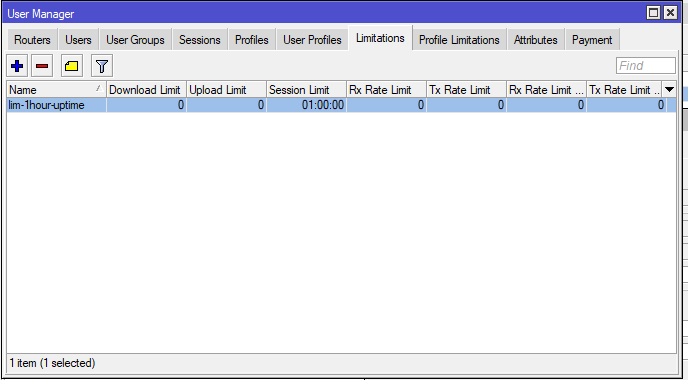

  • Intended policy: 1h total consumable uptime within validity
  • Limitation configured with uptime/session limit = 1h

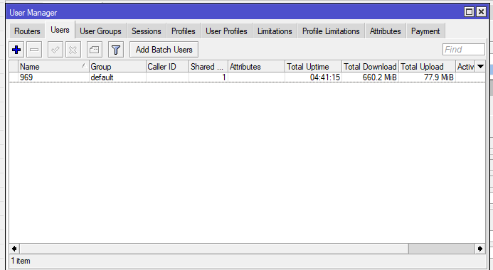

  • After reaching 1h accumulated uptime, the user is neither disconnected nor blocked
  • Voucher can be reused multiple times until validity expires
  • Limitation appears to act as per-session instead of total-uptime

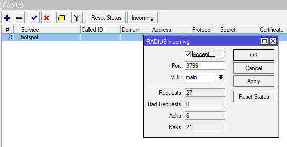

You need to have “RADIUS incoming” enabled for this to work. Look in the Radius config, it is a separate “button” (more like a “text” in Winbox 4)
You mean this one?
it is enabled already

  • Under RADIUS settings, turn on /radius incoming set accept=yes (like you already did).
  • Under RADIUS, for the instance you added turn on service=hotspot.

    • Add a limitation with reset-counters-interval=daily uptime-limit=1h.
    • Add a profile with validity=unlimited (not 1d like you did, the daily reset is done by the limitation above).
    • Under /user-manager profile-limitation add an association between the profile and the limitation created above.

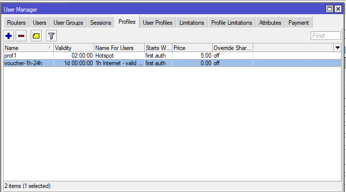

Hello this is my config
/user-manager limitation
add name=lim-1hour-uptime uptime-limit=1h
add name=voucher-1h-24h name-for-users="1h Internet - valid 24h" starts-when=
first-auth validity=1d
/user-manager user
add name=969
/user-manager
set certificate=*0 enabled=yes use-profiles=yes
/user-manager advanced
set web-private-username=admin
add limitation=lim-1hour-uptime profile=*3
/user-manager router
add address=127.0.0.1 name=router1
/user-manager user-profile
add profile=voucher-1h-24h user=969

In your export there is this entry:
That *3 is a reference to a unknown profile. It used to refer to a profile, but you've since deleted that, hence it now shows up in the export as *3. Which makes this profile-limitation entry invalid. You need to remove that entry and re-add the proper association between lim-1hour-uptime and voucher-1h-24h.
Normally when you see items in export containing *hex_number, the items are most of the time invalid (some exception like *0 which might point to a default entry) as a result of deleting entries without first editing anything that references the entries.
