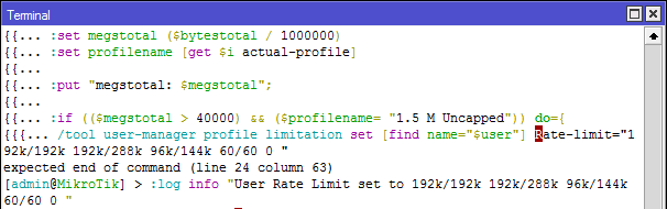

I had a script running in Usermanager 4 that could change the rate limits if a user used more than a 40 Gigs amount of data in a month.
I have in the mean while upgraded my usermanager router to routeros v5.21
This script does not work in usermanager 5.21 any more
I have tried making corrections to the syntax but it doesn’t work

Looks like the syntax labeling has changed… The Rate-limit label no longer exists.
…and has been broken up into multiple labels:
So, you’ll have to change this line of your script:
/tool user-manager profile limitation set [find name="$user"] Rate-limit="192k/192k 192k/288k 96k/144k 60/60 0 "
To something like this (except I don’t know what that last 0 (zero) was for in your code above…)
/tool user-manager profile limitation set [find name="$user"] rate-limit-rx=192k rate-lim
it-tx=192k rate-limit-burst-rx=192k rate-limit-burst-tx=288k rate-limit-burst-treshold-r
x=96k rate-limit-burst-treshold-tx=144k rate-limit-burst-time-rx=60s rate-limit-burst-ti
me-tx=60s

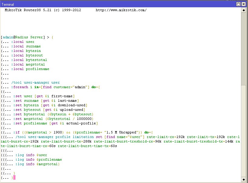

Hi Skot I am completely lost
The script executes only the log info at the bottom but the rate limits are not changed in user-manager
:local user
:local surname
:local bytesin
:local bytesout
:local bytestotal
:local megstotal
:local profilename
/tool user-manager user
:foreach i in=[find customer=“admin”] do={
:set user [get $i first-name]
:set surname [get $i last-name]
:set bytesin [get $i download-used]
:set bytesout [get $i upload-used]
:set bytestotal ($bytesin + $bytesout)
:set megstotal ($bytestotal / 1000000)
:set profilename [get $i actual-profile]
:put “megstotal:$megstotal”
:if (($megstotal > 1900) && ($profilename= “1.5 M Uncapped”)) do={
/tool user-manager profile limitation set [find name=“$user”] rate-limit-rx=192k rate-limit-tx=192k rate-limit-burst-rx=192k rate-limit-burst-tx=288k rate-limit-burst-treshold-rx=96k rate-limit-burst-treshold-tx=144k rate-limit-burst-time-rx=60s rate-limit-burst-time-tx=60s
:log info $user
:log info $profilename
:log info $megstotal}

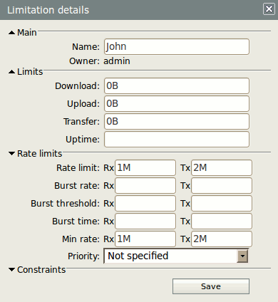

Using v5.22, the problem still exists. There are problems when setting values in User Manager > Profiles > Limitations > Rate Limits using the command line. (The web interface works fine. There I can add / edit / remove values without any problem)

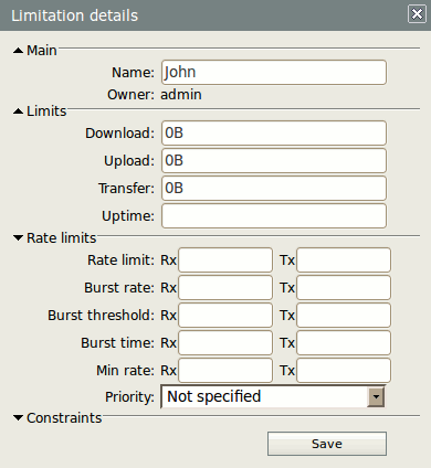

I start with a blank Limitation profile:
I try to add a combination of values, or a single value.
/tool user-manager profile limitation set [find name=“John”] rate-limit-rx=524288 rate-limit-tx=524288;
/tool user-manager profile limitation set [find name=“John”] rate-limit-burst-time-tx=90;
Profile remains blank:

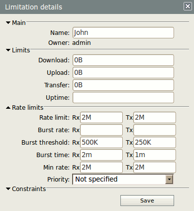

I use Web interface to add values, they work:
It seems that settings these values from the Terminal somehow hinges upon the Rate limit Rx and Rate limit Tx. If I set the Rate limit Rx or Rate limit Rx in the web interface, then I am able to add / edit any of the other rate-limit-… values from the Terminal, one at a time, or in a group. Setting these other values does not seem to cause any problems.
/tool user-manager profile limitation set [find name="John"] rate-limit-burst-rx=2M
/tool user-manager profile limitation set [find name="John"] rate-limit-burst-treshold-rx=512k rate-limit-burst-treshold-tx=256k rate-limit-burst-time-rx=2m rate-limit-burst-time-tx=60
Now if I try to set the Rate limit Rx and Rate limit Tx from the command line, I have mixed results. It seems setting values to a higher number works fine:
/tool user-manager profile limitation set [find name="John"] rate-limit-tx=5M
But sometimes a lower number might cause all rate-limit… values to disappear!
/tool user-manager profile limitation set [find name="John"] rate-limit-rx=512
Web interface still shows previous values, but when I log out / log back in, they are gone again, all blank.

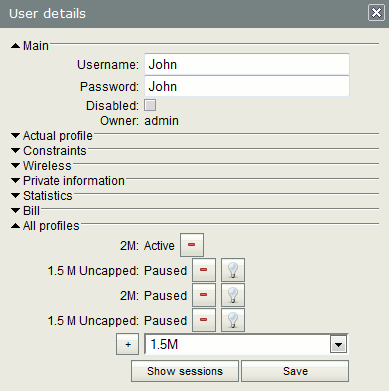

This command will create and activate a predefined profile for a user:
/tool user-manager user create-and-activate-profile UserName customer=admin profile="1.5 M Uncapped";

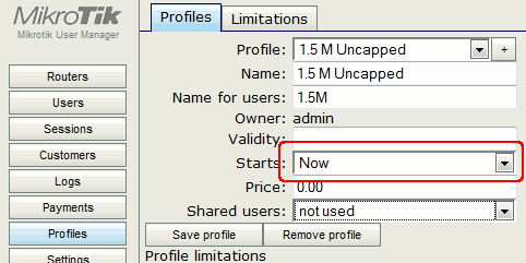

Depending on the Profile settings, this change will either start “Now” or “At first Login”
However, I don’t see a command to remove a profile. (You can view available commands by typing, for example, /tool user-manager user, and then pressing Tab):
So, running that command does change the profile, but causes the old profiles to keep stacking up… You can remove them from the web interface, but I can’t find where to do this from the command line…
Hi.
How can i Active the profile by the terminal?
Because if i add a new profile, the status is Waiting or Paused, but never is Active.
