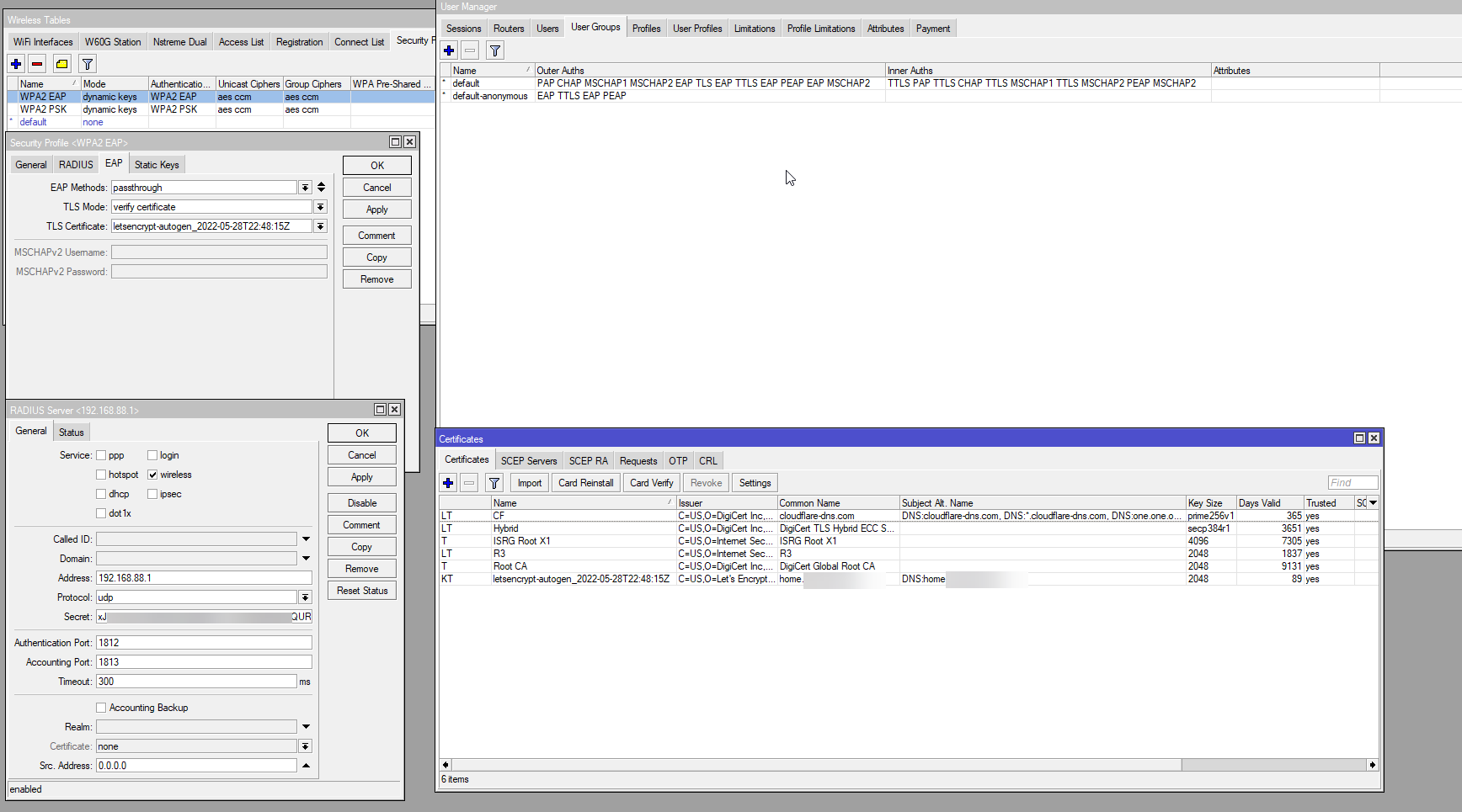

I had shown all of my configurations in the first post. I figured out that I couldn’t login authenticate because I didn’t have the right inner and outer-auths in my ‘/user-manager/user/group’ groups. But if I modify my configuration to the following,
set [ find default-name=default ] inner-auths=peap-mschap2 outer-auths=mschap2,eap-tls,eap-peap,eap-mschap2
I now can authenticate into MikroTik using RADIUS. I didn’t have enough time to play with the CAPsMAN configuration and see if that makes a difference. I also added this to my configuration (although it was authenticating to login) just in case,
/user-manager
set certificate=EAP_AP enabled=yes
I do think that it is a bug that if I delete the certificates and restore the configurations to how things were before I modified anything, RADIUS and the new user manager does not work at all. I needed to restart the router and reset the user manager database (although maybe just a reset was all that was needed.)

Thank you very much for that help. Okay, this is what I figured out.
  1. I needed to modify some of the inner-auths and other-auths in order to get login to work. THIS WAS THE TRUE PROBLEM.
  2. I was trying to get my CAPsMAN router to connect to a working RADIUS server, but my firewall was blocking that. If you are looking at this as reference to know how to get your RADIUS server to work, figure out how to get your firewall working out before doing this.
So. Using certificates didn’t brake anything. It was my firewall and trying to connect to a new router. Hope this helps someone.
