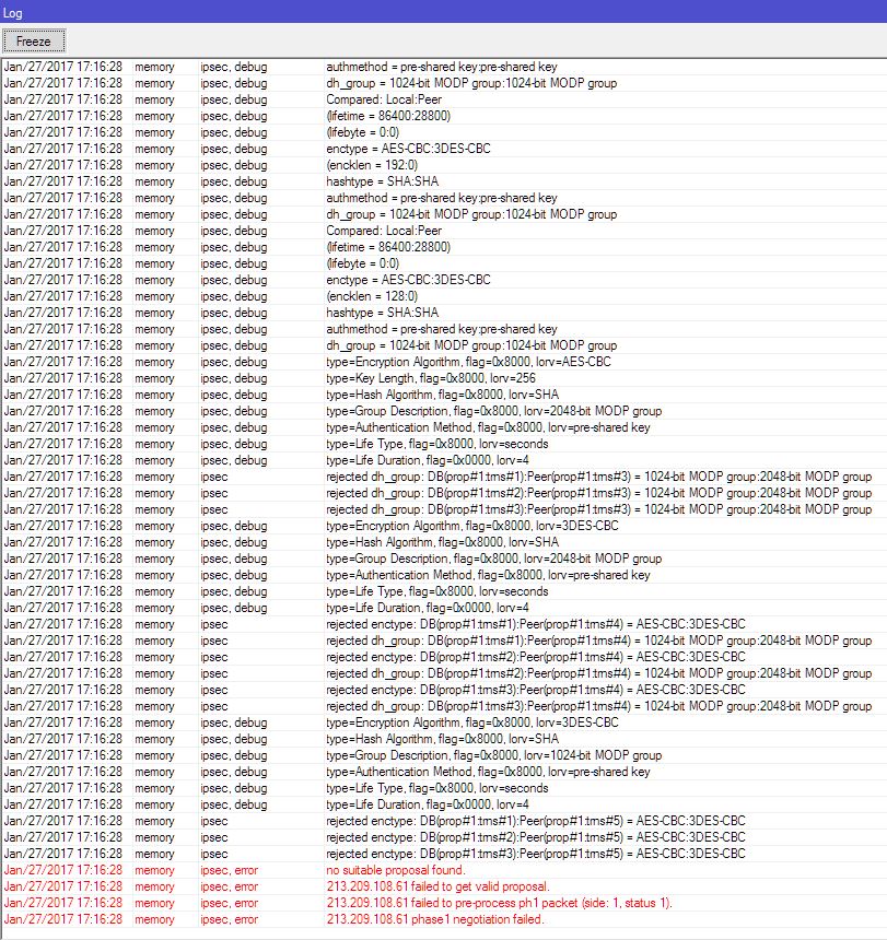

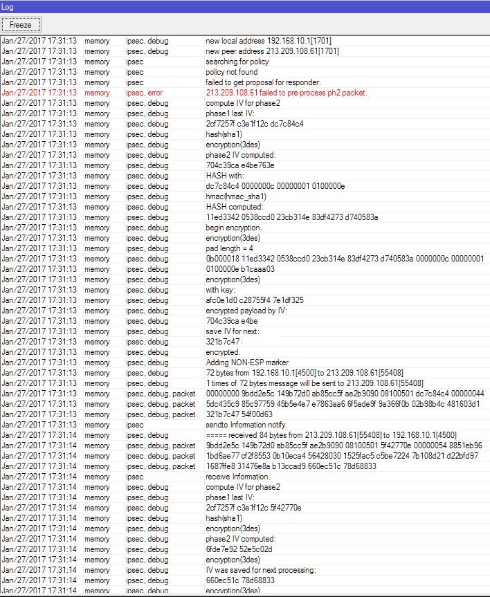

i tried config my L2TP/IPsec on my rb1100 for iPhone OS10 client then i follow the step by step above still not working any one can help me if i have something messing on my configurations also i got this error message on my logs.. but behind NAT my L2TP working find..
https://ibb.co/moL6fa
07:38:53 ipsec,error failed to get valid proposal.
07:38:53 ipsec,error failed to pre-process ph1 packet (side: 1, status 1).
07:38:53 ipsec,error phase1 negotiation failed.
07:53:11 ipsec,error failed to get valid proposal.
07:53:11 ipsec,error failed to pre-process ph1 packet (side: 1, status 1).
07:53:11 ipsec,error phase1 negotiation failed.
Enable ipsec debug logs, it will show what phase2 parameters exactly are mismatched.
