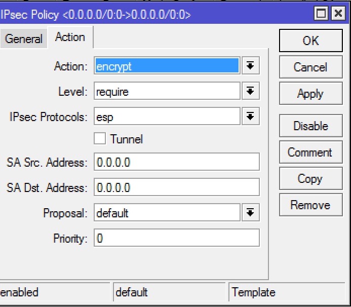

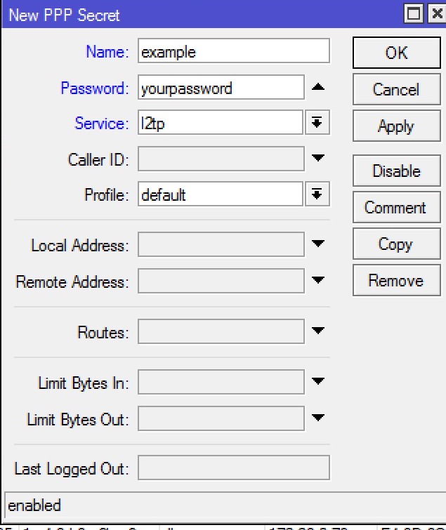

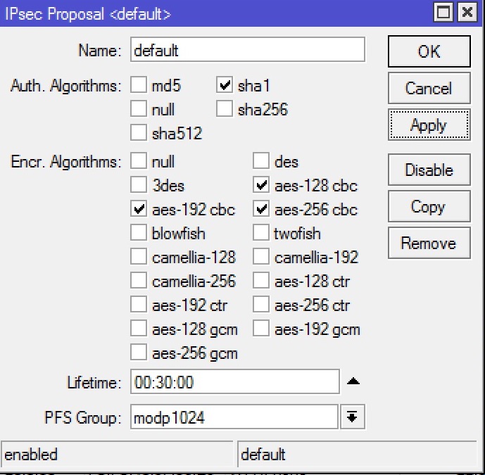

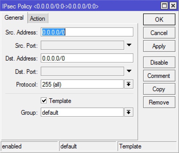

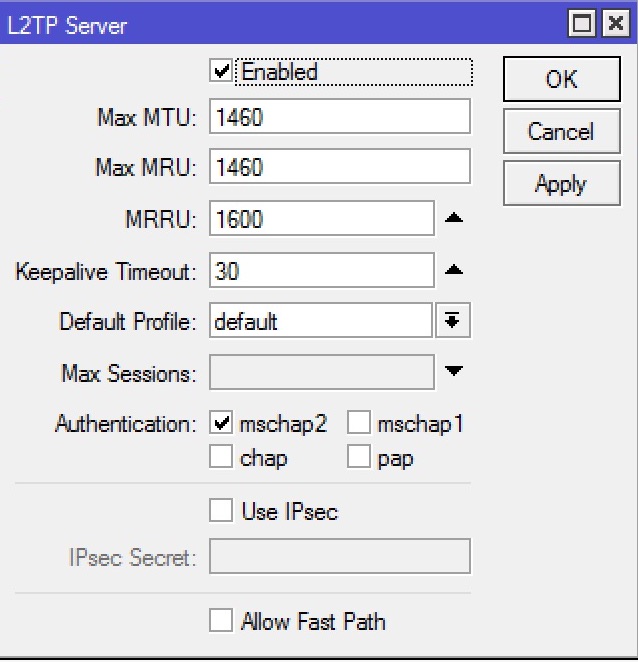

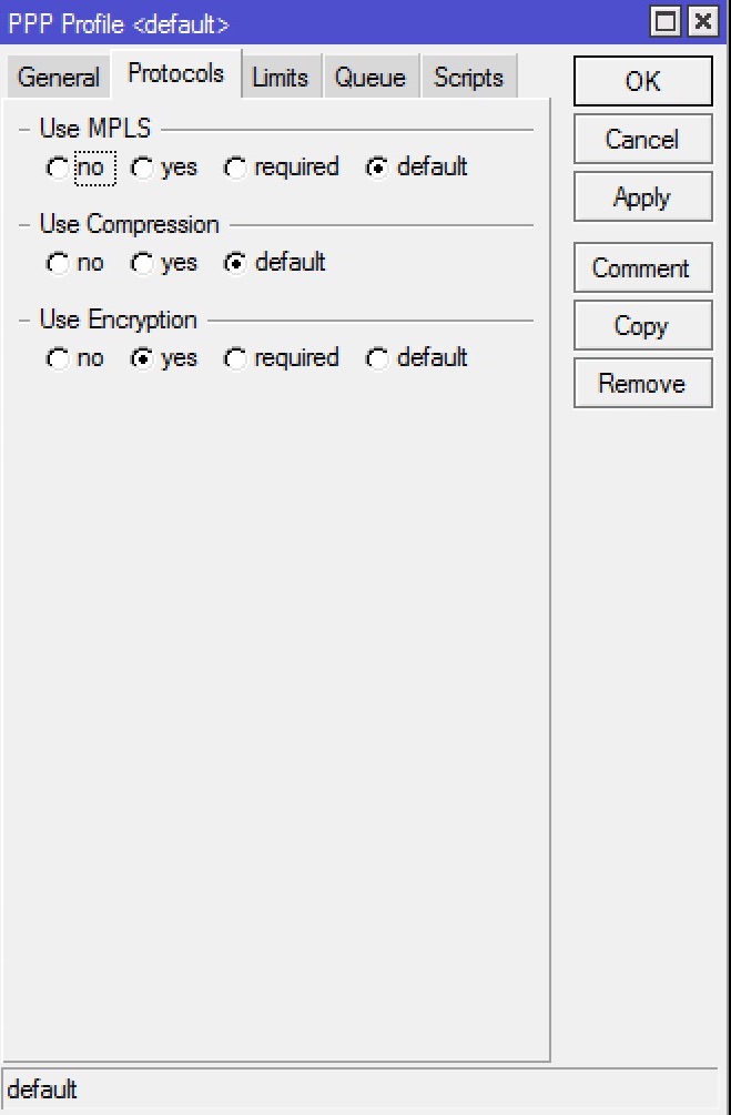

I’m not a Mikrotik expert, but I know some basics. Yesterday, my sysadmin friend came over, who taught me how to use a Mikrotik, to set up a VPN server. We started with PPTP, but in iOS 10 (and macOS Sierra), Apple will remove it. So we moved onto L2TP/IPSec. We spent an hour trying to set it up, but it wasn’t working on iOS 10. Then we tried it on iOS 9.3.5 and it was working perfectly. iOS 10 still returned an error that “The L2TP-VPN server did not respond.”. The log had the error “phase1 negotiation failed due to time up”
I found this page, today I started again and set it up based on this, with no luck. https://www.nasa-security.net/mikrotik/mikrotik-l2tp-with-ipsec/

The latest OS X and iOS betas work fine with L2TP/IPSec VPN. If configured properly what works in iOS 9 should work fine in iOS 10. On iOS you sometimes need to delete and re-add the profile even if you have all setting entered correctly.

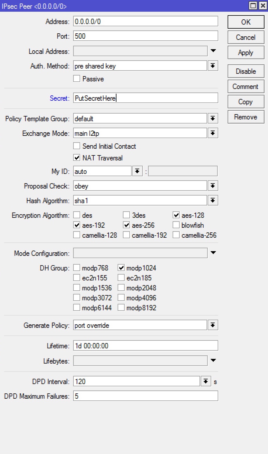

I’ve managed to set it up again, so I can connect to it with iOS 10 too. I thibk the problem was with one of the encryption setting. However, I still have problems with the connection. I can send data (I can see that the router receives the packages), but I don’t get anything back, unless I want to reach a local address. (I can connect to the NAS on the network, but can’t use Google.)
I’m going to experiment with it on Monday, the problem must be one of the settings.

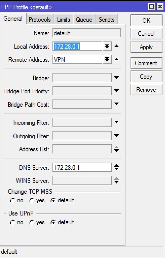

How do you access internet through the Mikrotik? If it´s throug NAT masquerade, make sure that your VPN IP range is being masqueraded too.
I’ve changed my settings to @WillMoore’s but it’s still not working properly. I can connect to it now, but I can’t access the devices on the network. I have two Synology NASs and I can only open one of them even though they’re on separate IP. I can’t connect to the router either with VPN. I tried to open some websites too but none of them worked.

For those of you having issues connecting to local network - The interfaces must be set to Proxy-ARP on the LAN Side.
