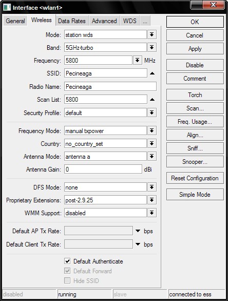

you must add in the scan list at station side the used freq.
Sorry to sound like an idiot, but can you give me an example please?
http://www.mikrotik.com/testdocs/ros/2.9/interface/wireless_content.php
scan-list (multiple choice: integer | default; default: default) - the list of channels to scan
default - represents all frequencies, allowed by the regulatory domain (in the respective country). If no country is set, these frequencies are used - for 2.4GHz mode: 2412, 2417, 2422, 2427, 2432, 2437, 2442, 2447, 2452, 2457, 2462; for 2.4GHz-g-turbo mode: 2437; for 5GHz mode: 5180, 5200, 5220, 5240, 5260, 5280, 5300, 5320, 5745, 5765, 5785, 5805, 5825; for 5GHz-turbo: 5210, 5250, 5290, 5760, 5800
like this
