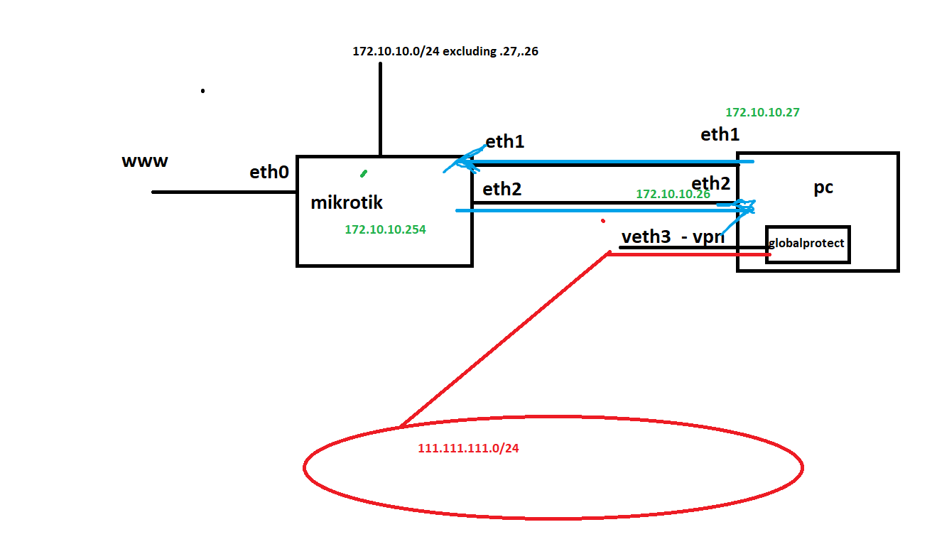

Can you put up a diagram of your network please? Your text description is not clear to me at leas.
next is the sample image you request
pc has eth1,eth2 and virtual eth3
i want one of the ports to be a normal config (so vpn will work) and the other eth2 should be able to work as a routing port, so we can share 111.111.111.0/24 network with 172.10.10.0/24 and anyone could use it .
nat is preffered to make it look as if 111.111.111.0/24 reached only by pc, so they wont find out some different pc might access it

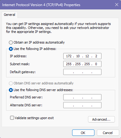

Assuming that your Windows version is recent enough (up to date Windows 10 or Windows 11), this can be done, but you'll need to configure NAT on the Windows device.
  • First, you should give the 2nd network adapter on the PC another subnet, instead of using the same 172.10.10.0/24 subnet. For example, let's assign 172.10.12.2 netmask 255.255.255.0 and no gateway on this 2nd network adapter of the Windows device:
  • On the MikroTik router, add an additional address entry to the bridge interface that currently has 172.10.10.254/24 assigned, let's assume the bridge is named bridge1:
    add address=172.10.12.254/24 interface=bridge1
    Please note that we've added the same 172.10.12.0/24 subnet as the one of the 2nd Windows adapter to this bridge interface, so that it has two subnets!
  • On the router, add the route for the 111.111.111.0/24 subnet to use the address of the 2nd Windows adapter as gateway:
    add dst-address=111.111.111.0/24 gateway=172.10.12.2 routing-table=main
  • On the router, configure masquerade for the destination subnet:
    add action=masquerade chain=srcnat dst-address=111.111.111.0/24
  • On the Windows machine, configure NAT with this command running in an elevated (admin / UAC) Powershell command prompt:
    New-NetNat -Name "NAT-FOR-VPN" -InternalIPInterfaceAddressPrefix 172.10.12.0/24
    Here is the documentation for New-NetNat: https://learn.microsoft.com/en-us/powershell/module/netnat/new-netnat. From the side menu you can also access documentation for Get-NetNat and Remove-NetNat to manage the created NAT rule.
That should do it. Of course, if you have time, you can also improve the network configuration on the router by adding a VLAN specially for this purpose. The VLAN will have ether2 on the router as access port and you can move the 172.10.12.254/24 address assignment to that VLAN interface instead of keeping it on the bridge interface.
