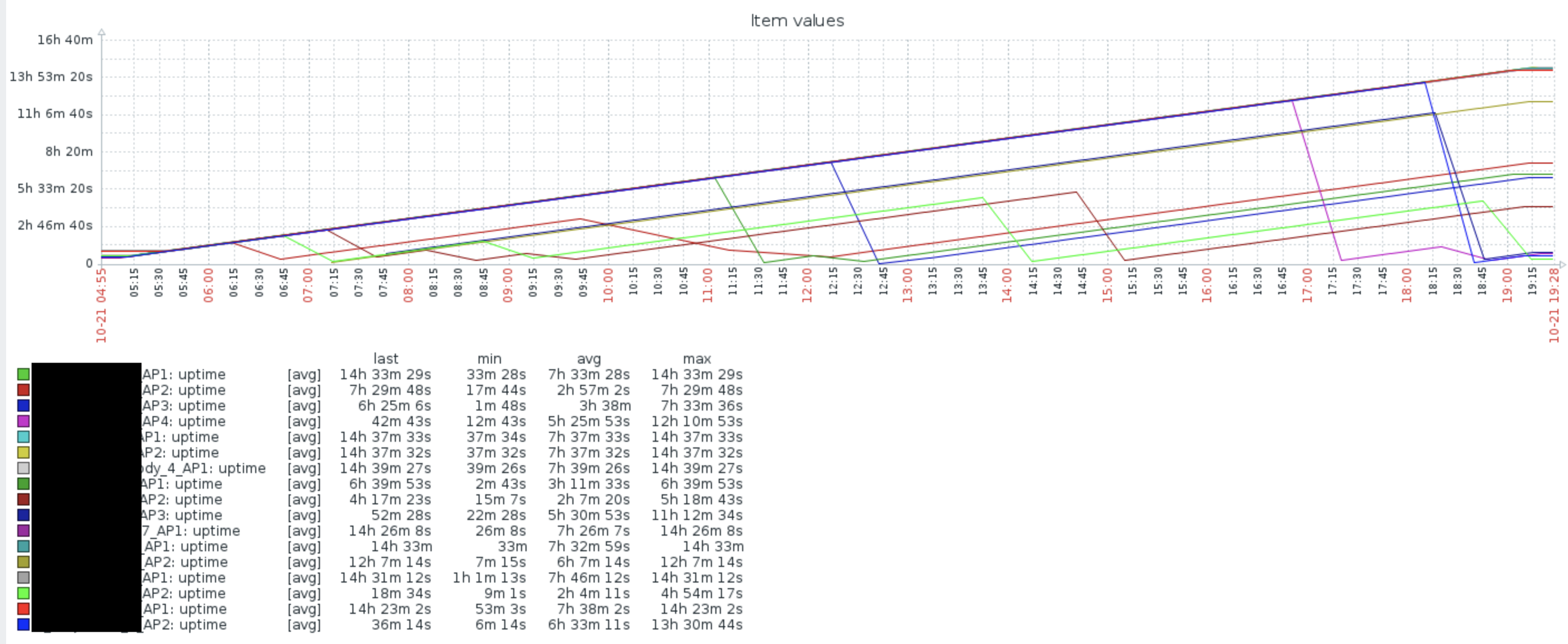

After upgrade, my Metal G-52SHPacn starts rebooting
