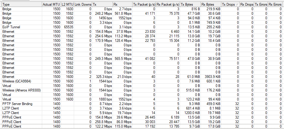

Board: RB4011iGS+5HacQ2HnD
Problem: on all ros 6.44.x-6.45.x on PPP client/server interfaces (L2TP, PPTP, PPPoE) appear at the same time small Tx Drops counters. On ros 6.43.16 works well on same config.
