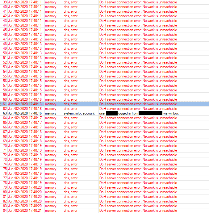

And seems like the DoH log spam wasn’t fixed that was reported during the betas. You need to tone them down a bit because this is ridiculous. I know that it stops after connection is reestablished but is it necessary to have the DoH server connection error: Network is unreachable entry for 2-7 times per second? Just look at it:
