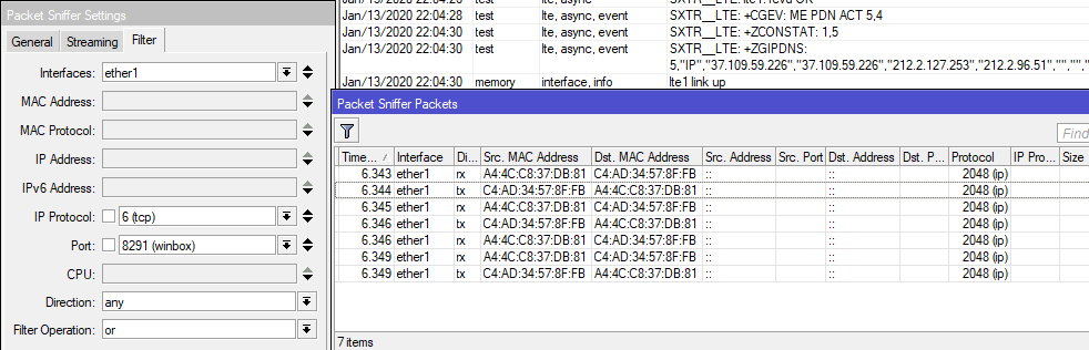

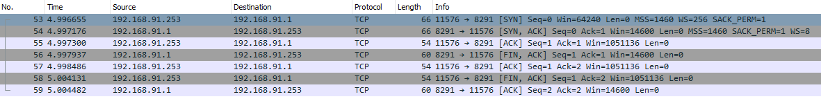

Error 1) Cannot login via RoMon and WinBox (by IPv4).
Upgrade SXTR+R11e-LTE6 = not possibility to login via RoMON and WinBox by IP.
MACTelnet and WinBox via mac-address works. Logs:
16:46:50 echo: system,error,critical login failure for user marcin.przysowa from 192.168.88.253 by romon 00:00:00:00:00:01 via winbox
22:25:22 warning denied winbox/dude connect from 192.168.91.253
I type many time's the same credentials. They works via MacTelnet, not works by RoMON. I create a super easy asd user with password asd123 and still the same.
New Sniffer not see the incomming IPv4 but MAC-ADDRESS-es but in logs he report the IPv4 and tools torch see the IPv4.
from PC
