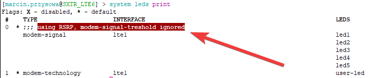

Then please fix the LED display who give us info in WinBox about modem-signal-treshold=-93 who in only CLI give info that WinBox give fake information, CLI:
Shouldn’t that be “threshold”?

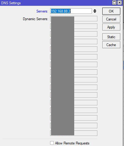

Any chance that dynamic DNS servers in IKEv2 can be deactivated? I have a long list to which not should be connected (NordVPN). Putting a ICMP reject (output) on it helps a bit but rather I have them ignored if the user wants that. Like as it possible in L2TP/IPSEC.

*) dns - use only servers received from IKEv2 server when present;
Is this the cause that using NordVPN is not working anymore in this Beta if using a local DNS?
It is no fun looking at and being forced to use that list of dynamic servers while not wanting to use them. I want to use my Pihole at 192.168.88.2
IMHO that’s a bad change. I have an open wifi network for guests, client traffic is routed via IKEv2 provider. I do not necessarily trust this provider - I just want to hide my public IP address for unknown clients.
Traffic from known clients and router itself goes via ISP, the same should be true for DNS traffic.
I understand the idea for that change, but sending all DNS traffic to a VPN provider without the data itself does not improve the privacy or security situation. More the contrary.
Any chance to have a setting for IKEv2 peer (or mode-config or whatever…) named “use-dns” with three valid values: yes, no and exclusively?

I like to add to make to naming more clear like “Use Peer DNS” as it is used else where in ROS.
By exclusively do you mean that the dynamic DNS is resolving only for that link? Not going into the pool of Dynamic DNS servers under IP-DNS.
Please give us the option, to not use any dynamic servers at all, no matter what the source is.
I don’t want to use any kind of dynamic dns servers, for obvious reasons.
Who is using the dns servers the vpn/isp provides anyway..
Using the dnsservers from the VPN providers is wished for and so you avoid leaking DNS data.
However if you have your own server you want to ‘leak’ to your own server. This is for advanced users and the default setting should be, using the dynamic servers.
