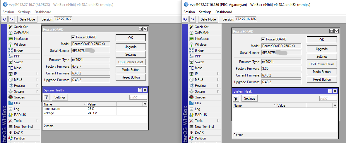

Model “RB750Gr3” displays status, but model “RouterBOARD 750G r3” does not
I have removed the verification of the certificate. Will have a look at log tomorrow.
Info from my router.
RouterBOARD 750G r3
So its not correct what you write, mine works.

[quote=RedRoger post_id=853046 time=1618376261 user_id=182785]
RB750Gr3
Menu System/health is still empty
[/quote]
Thank you for the report!
Your RouterBoard has exactly the same name. One work, another not. As other writes, try some more reboots.
Mine has worked fine with all the version, so there may be a combination of factors that gives this problem
