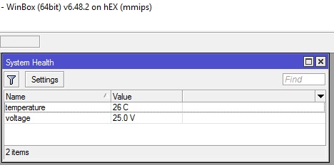

Mine 750G r3 do show System Health on RouterOS 6.48.2 using WinBox
