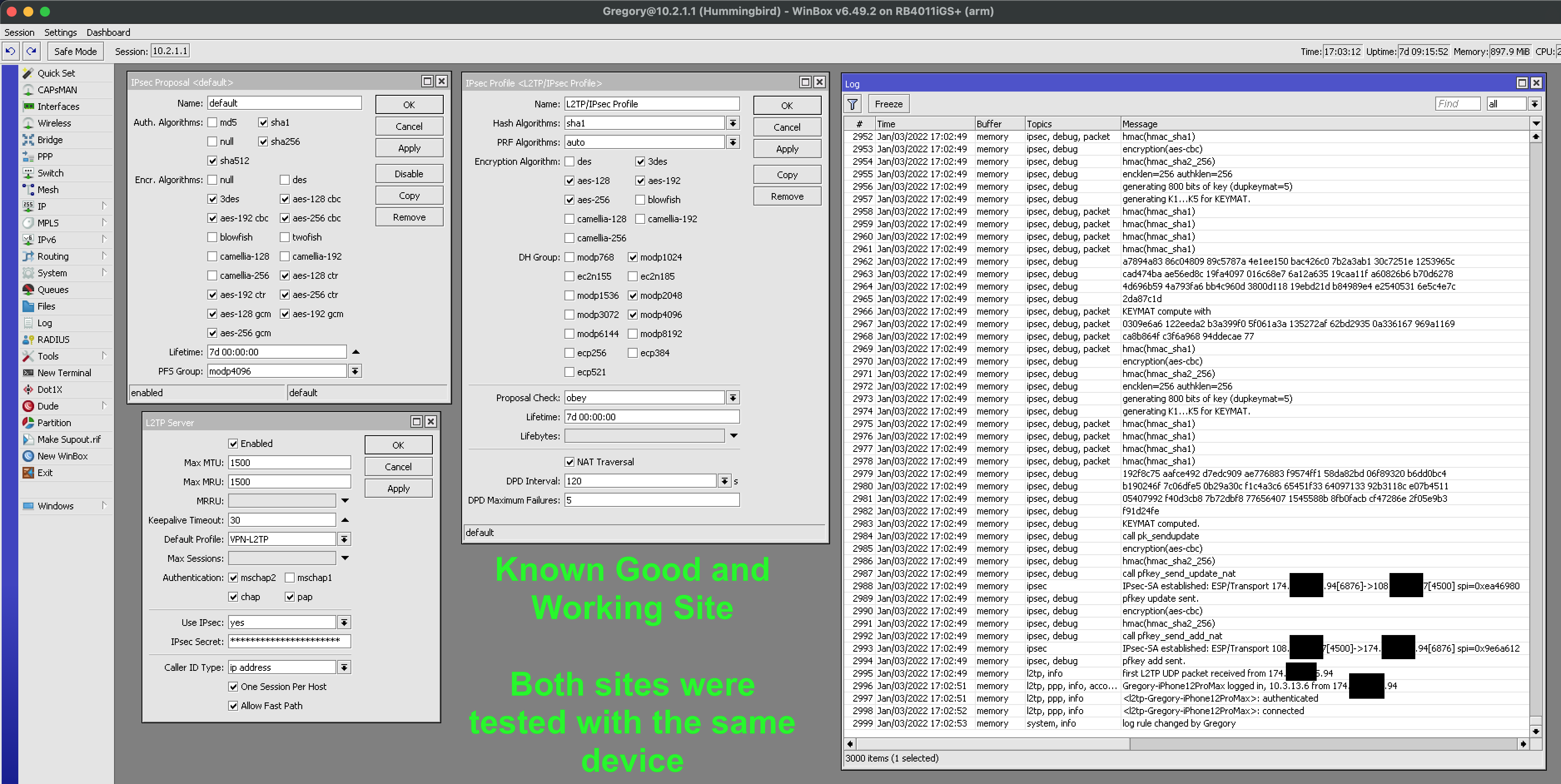

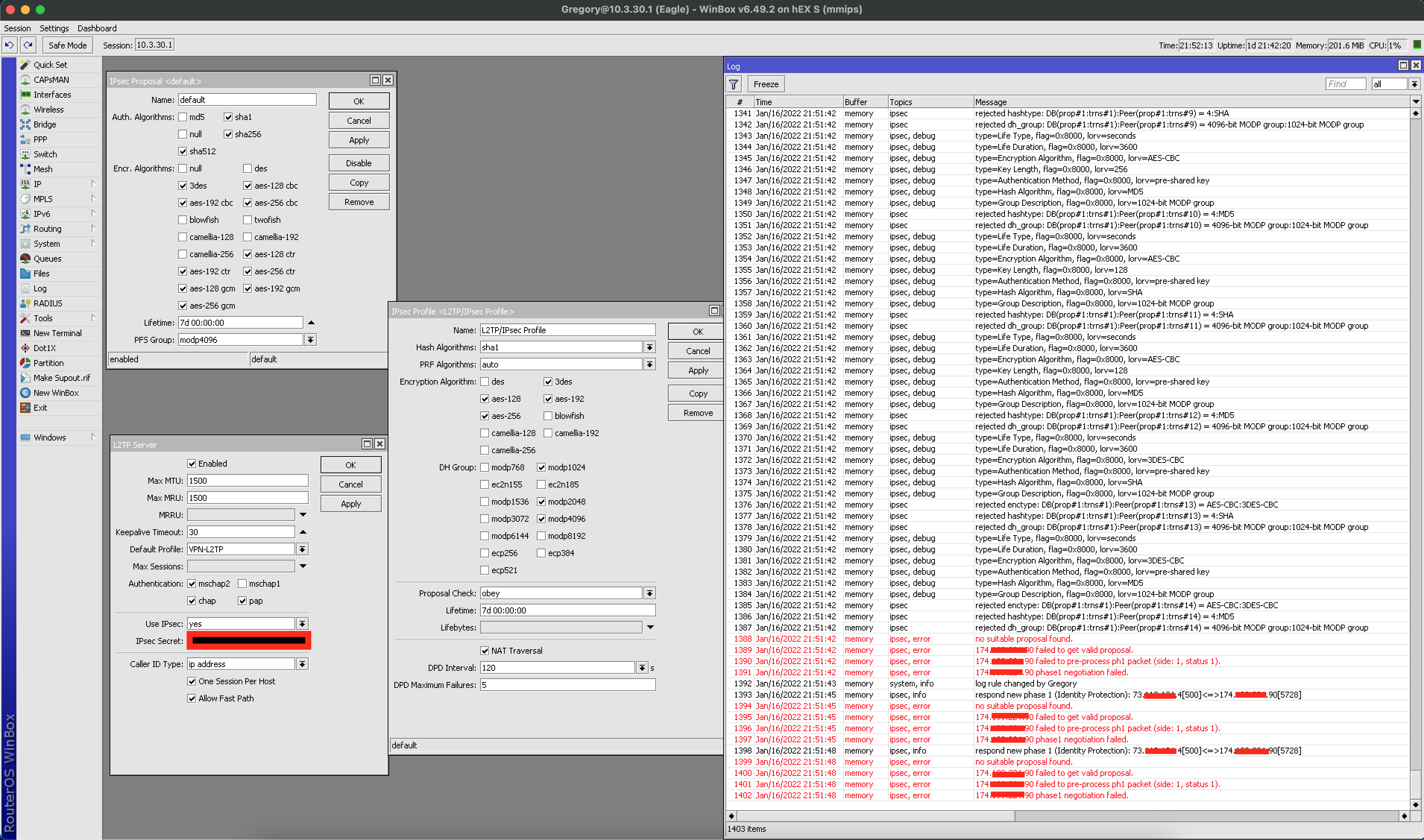

I upgrade a sites hEXS to 6.49.2 from 6.49.1 and haven’t been able to make an L2TP/IPSec tunnel since. I then tried to upgrade to 7.1.1 and didn’t have any luck either. I then tried Netinstall to do a fresh install of 7.1.1 and still had the issue. I then tried Netinstall with 6.49.2 and still can’t remedy the issue. I have combed the logs from IPSec and it looks like the hEXS isn’t checking the full IPSec config. This config has worked for 4 years no without any issues until these updates. I need to restore this issue asap as it is a primary site. I did try rolling back to several older configs that were known good and untouched by the update with no luck. I have tried contacted Mikrotik Support and got no where.
It appears to be an issue with the 6.49.2 through 7.1.1 firmware specially on the hEX S (MMIPS) platform. It doesn’t appear to be checking the config even after I apply the changes; even after disabling and reenabling. I have attached a screenshot of the hEX S and RB4011 config. The RB4011 is a known good and working config used on multiple sites and the hEX S matches but doesn’t work. One note worth thing is the hEX S appears to be having trouble with the MODP group. I tried disabling it and then using 1024 which is what the log was suggesting but that didn’t work.
@Beachbum: Look closely, the non-working one doesn’t have modp4096, which is also what you can see not matching in the log.
Unfortunately, that was remnants from me trying to disable and enable different options trying to get it to try different options. Enabling that has no change as it appears to be stuck on 1024 vs 4096.
