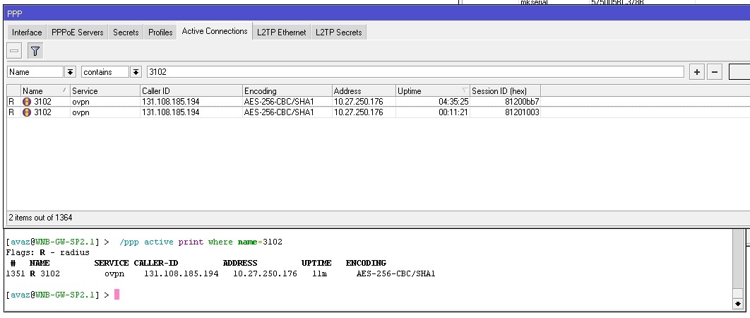

I upgraded my CCR1036 to version 7.1.1 , but I noticed an item in openvpn
In ppp active sessions , I see two sessions in winbox for the same user but I can’t see these sessions in the command line
Is this a winbox or os router bug?
